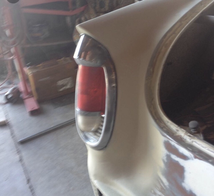

    Are those tailights installed correctly?
    The chop and car is beautiful.

    I drove a 56 Merc Montclair 2 dr hardtop as my HS car back in the 70's. I've never seen one chopped that I liked ,until now. Well done!!
    Those look like the stock tail lights that have been remounted and angled 19Fordy. A nice custom touch.

    The tailights are installed .... i cut them and layed them foward 3&1/2”

    I like them angled like that. I was looking at this yesterday trying to figure out how you had extended the quarters o_O I'm glad you explained how you did it.

    I owned it for several years.it was my daily driver clocking roughly 100 miles daily. Originally built by kelsey Martin of mass. 2" chop, 4" section and 5" stretch in the rear quarters to accommodate the 55 merc wagon taillights.
