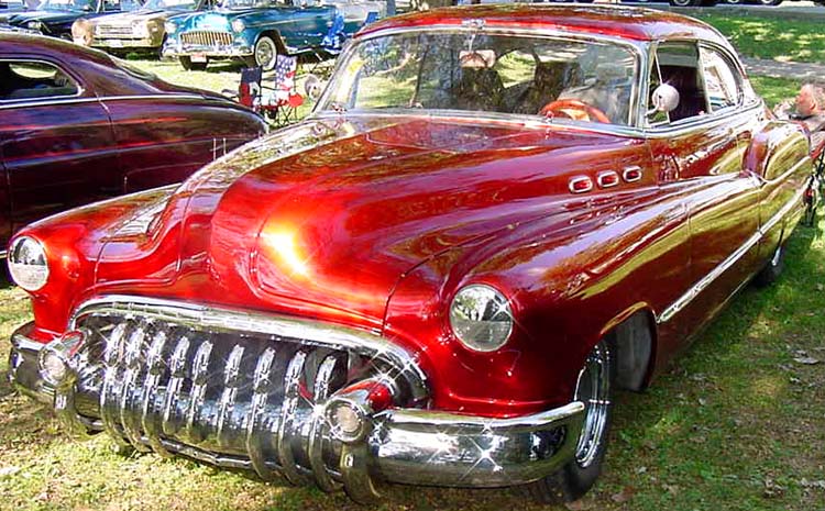

    This an early 50's Caddy that belongs to a friend of mine. It isn't a Buick but has pretty much the same top and lines on the upper body. Not getting carried away and taking too large a chop is the key to looking right rather than squished on this roof style.
    I think he took some metal out of the roof above the rear window but am not positive.
    That might give you some ideas on how to get it right though.
    I don't think I got any photos the one time I saw it when he was building it so I don't know what he did with the top but he did have a parts car that he may have taken a section of the top from to stretch the top when he dropped it.
    Clicking on any photo will take you to the album that it is in so you can see all of the photos full size plus a couple of extra ones of it.

    Thats a nice chop! I think iam going to do like 2 or 2 1/2 inch, i like when its almost dont looks like its lowerd.
    Dont want to destroy the "roof line"

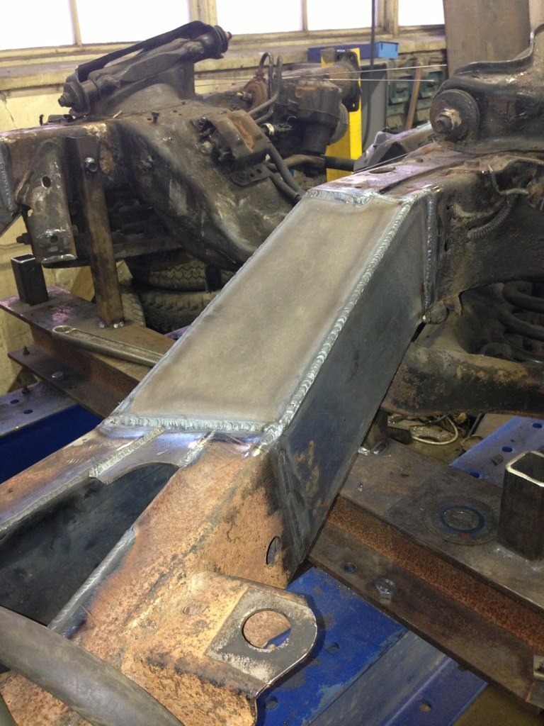

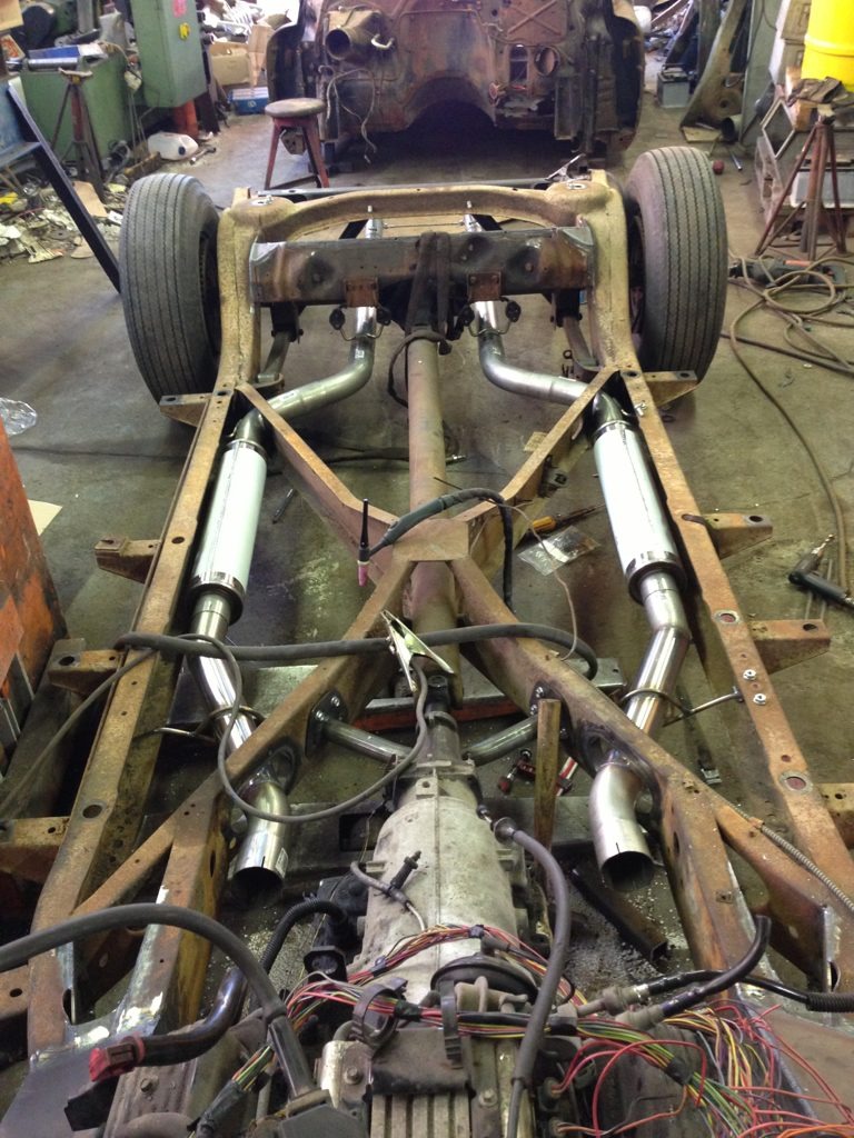

    Thanks for all feedback, i like the challenge to chop it not only the look. I know all Stainless trim is a hard task to deal whith. Last winter i help d a friend to do all trim on his 3" chopd 39 mercury carson top, including build new round glass trim for side Windows.
    Took about 30h to complete.
    I hope to see some more pic or info how to start this project, iam allready have the chassie done w 96 roadmaster front and rear. ImageUploadedByH.A.M.B.1375015782.676789.jpg ImageUploadedByH.A.M.B.1375015946.966636.jpg

    Yehh i think i have done the chassis right, runs really good. But the motor is nothing i bragd about, lol.
