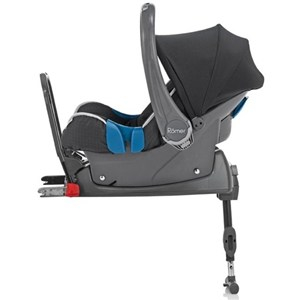

    I know this might be of topic, but also a very simple solution.
    In my OT DD I install something called a ISOFIX bracket. But it's simple and out of the way, and it doesn't ruin the look, but still stays safe.
    All it actually takes is this brackets are bolted to a safety belt hole in the floor.
    The seat it's only clicked on the brackets, like a modern seatbelt bracket.
    This would fit perfect in a truck. And when the seat is removed from the car, you almost can't see them between seat bottom and seat back.
    And most car seats has them today.
    And if you applay the same amount of pro behavior as building a cage, this should be a work in the park for most HAMBers, regardless of its a 1926 T body, a 36 roadster or a 55 First series or a Chevy II 64.
    I would be much safer to fringe your kids (grand kids).
    And I most confess, that mounting a 3 point seatbelt in the sheet metal cab corner of AD, wouldent make me happy.

    It's possible to do it the right way, between dangerous and bubble wrap.
    See below. I plan on doing the same same thing.
    You all have good and valid points. But the set up refers to, will work on all old cars!
    Will not require any mods, to most seats. No re upholstery, and Dosn't matter if you have a Fairlane, Camaro or WWII jeep. Or mode T
    I might get the measurements, if people wants them.
    Yes HRP. The seat I posted about is the same I use for my 5week old, and used for my daughter. She now sits in a bigger seat, facing forward, but still with the ISOFIX mount.
    The set shown can be used to a certain age/ size.
    The top part can be lifted of and carried like a basket on ones arm.
    I might be a "car guy safe"-person, when it comes to me, but not when it comes to my kids!!!
    But I'm thinking about making a set up for my Volvo. They are very simple and will fit in the lower seatbelt bolt holes. That's all they need.
    The volvo, Saab and VW came with this set up, from the factory, so the seat should be avalible state side. If not nothing is further away then a mail! We might even be able to swap seats for parts I need for my dry lake build.

    I might have come a bit ahead of my self, we call it ISOFIX, you (US) call it LATCH.
    "Lower Anchors and Tethers for Children"
    But my point is still valid.
    More pics of the brackets. These is for another car. But should be adaptable.
    The center distance between loops is 280mm.
