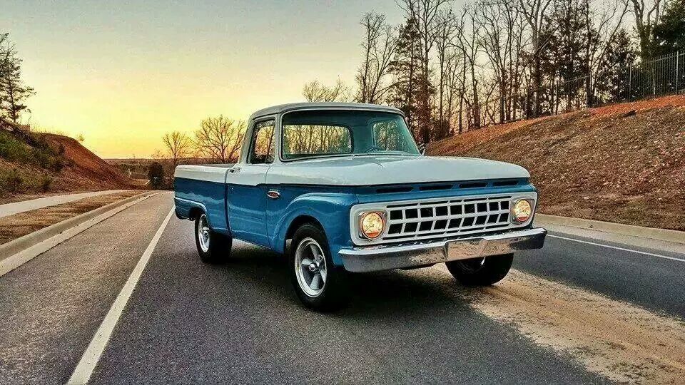

    I have a 65 ford f100 that my 3 year old son loves. Up to now, i've not had any seat belts in the truck... But, now that he is old enough to enjoy it I want to start taking him with me instead of just working on it or pretending to drive it. I have the seat out of a 89 GMC that has the seat belt provisions. I know I can easily get a lapbelt to put in the truck. ( the truck has the mount points for seatbelts... as it was an option for those years and not standard. My question is what are you guys doing with your kids and child safety seats. lapbelts.. 3 point belts.. custom.. Any advise im open to and any resources you can share are appreciated.
