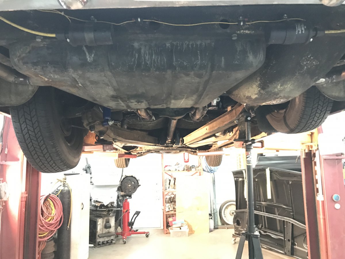

  20. ebfabman
    Joined: Mar 10, 2009
    Posts: 505
    ebfabman
    Yep, they twist.....
  21. Since this 6 year old thread was brought back up, I'll add my 2 cents
    The twist is the reason that NASCAR Mandates that the arms be I Beams!
    Hnstray likes this.

    Photos prove a lot. The flex is necessary.
