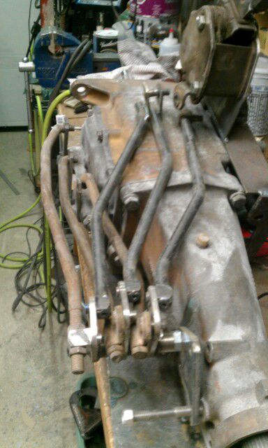

  11. Thanks I do appreciate you taking the time to reply but again I have zero concerns of what it will or will not bolt up to as far as mounting or linkages as I am not mounting it to the traditional spot on the transmission and have modified the linkage to work with my needs. I just needed to verify that the way the levers will work is the same for the transmissions Hurst listed with the shifter and a Saginaw. I am still a little uncertain what differs between shifters that justifies a $60 price difference in what looks like essentially the same unit with a different shaped lever but at this point that answer may not be available.
    Sorry I should have posted this earlier to avoid some of the confusion but couldn't find the picture. This is what I am doing and needing to replace the ITM unit in the picture.

  12. Thanks so I assume the reason for the differences in shifter model number suggestions would be the handle and the differences in the levers that would correspond with specific mounting applications in different cars?

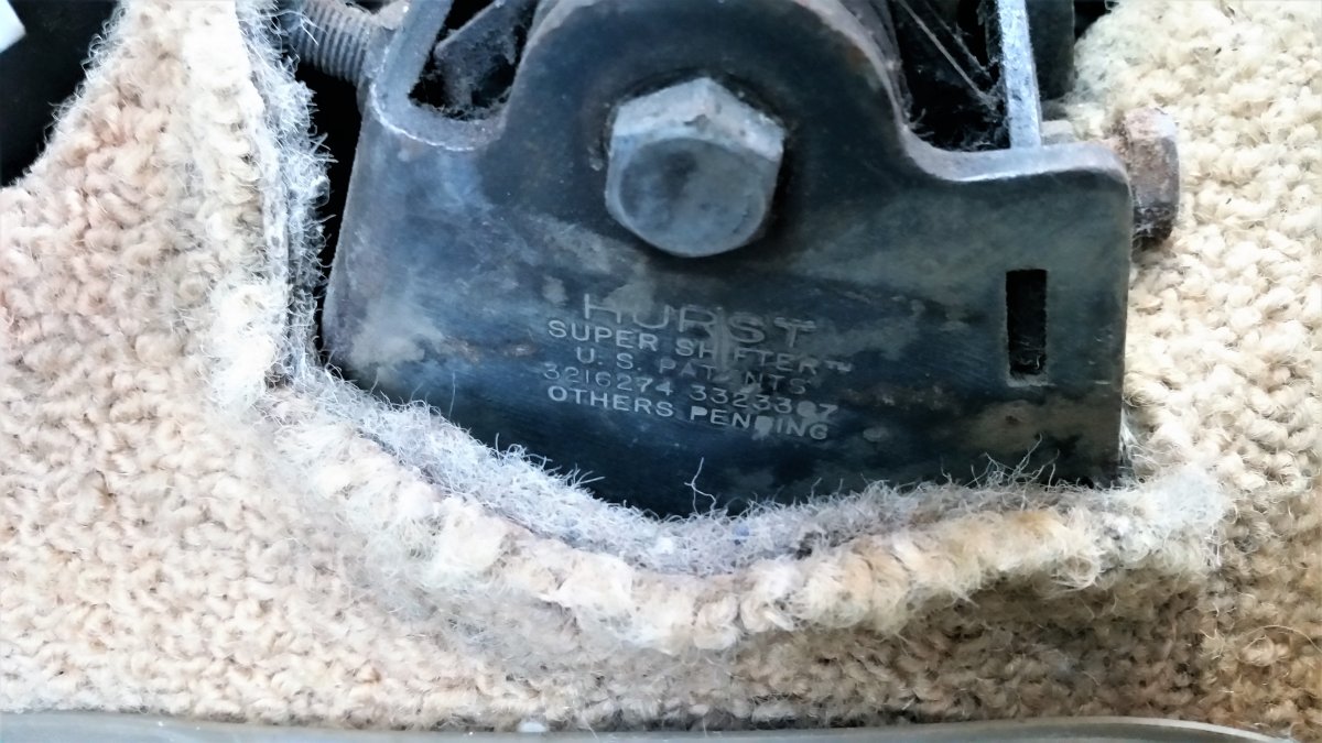

    This is the shifter body in my Chevelle.
    This one doesn't have the funny shaped reverse liver like the corvette shifter.
    Not sure if the number on this will help or not.

    sorry here's the picture.
  15. Thanks. A quick look online looks similar to the one that Hurst lists for the Chevelle with the Saginaw and looks like the ITM I have. That would be the easiest to use for me but it's going to cost at least $200 more than what I would pay for the Corvette one with the funny lever so if the only difference is the lever it makes no sense to me to pay $200 more to save cutting up and re welding one lever.

    Cutting and welding a shift lever my be tricky.
    At least you won't be banging reverse. ;)

    I do have a T 10 on the bench now, and it uses the same shifter body as the one in my Chevelle.
    Hard to imagine someone up your way doesn't have a shifter for sale.

  23. chubbie
    Joined: Jan 14, 2009
    Posts: 2,336
    chubbie
    I like your shifter mount! I did the very same thing in my model A and sagi trans.
