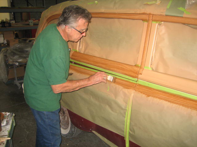

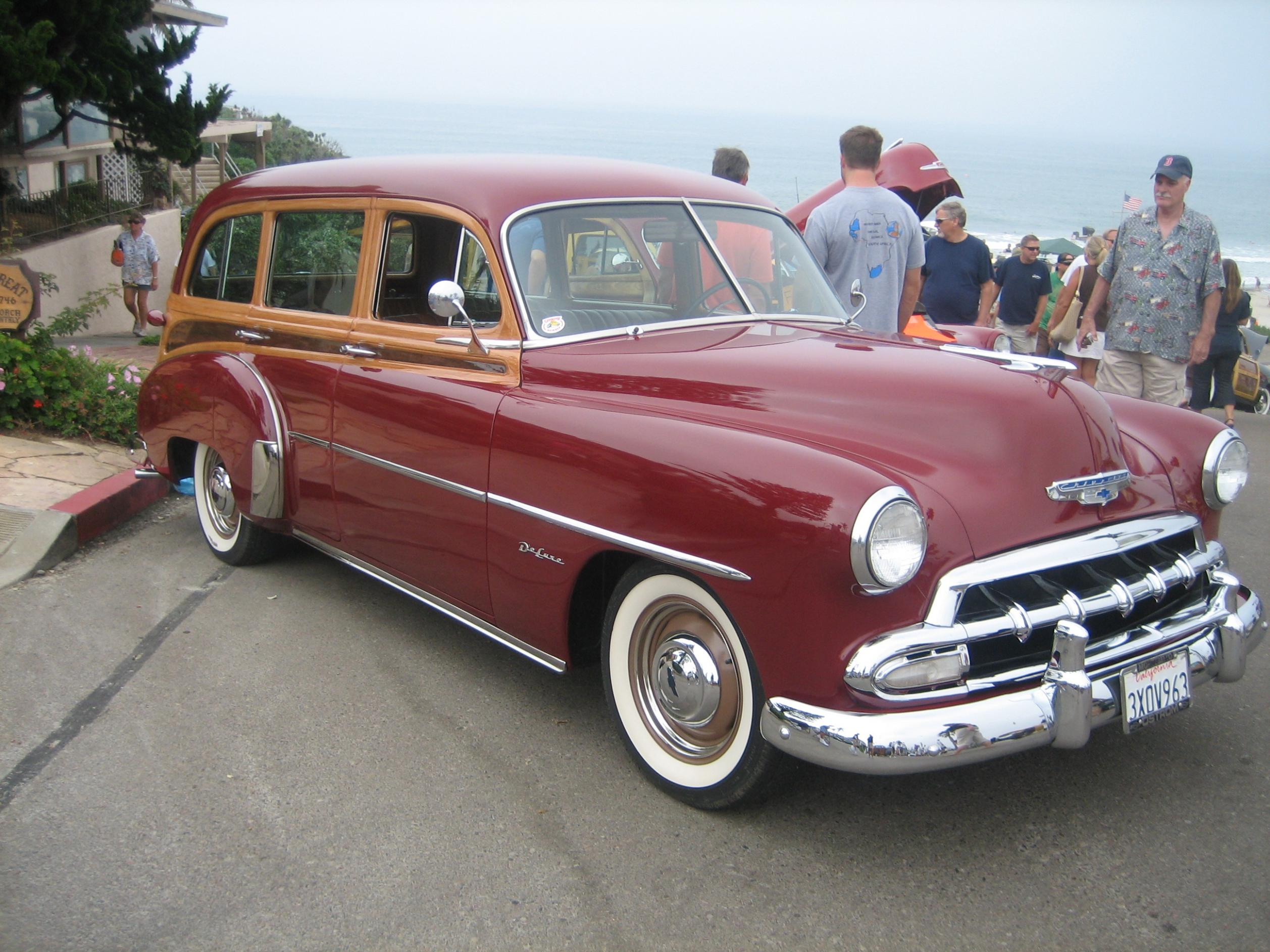

    Here's some pics of one that was done by Lyle Fisk and myself . We made our base and grain colors.

    philly, say your wagon at Del Mar, it was one of my favorites there
