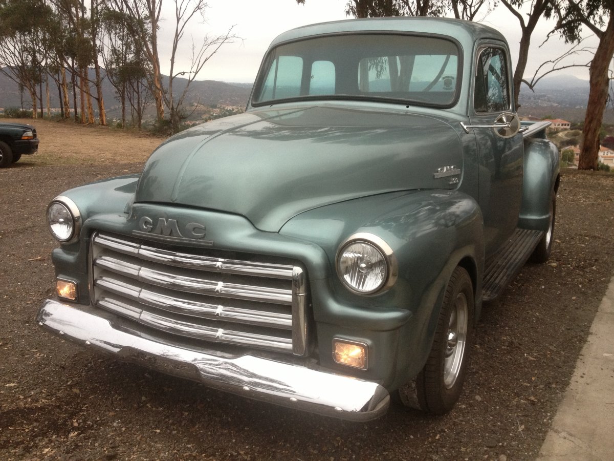

    Here is mine. 54 GMC on a 93 Silverado
