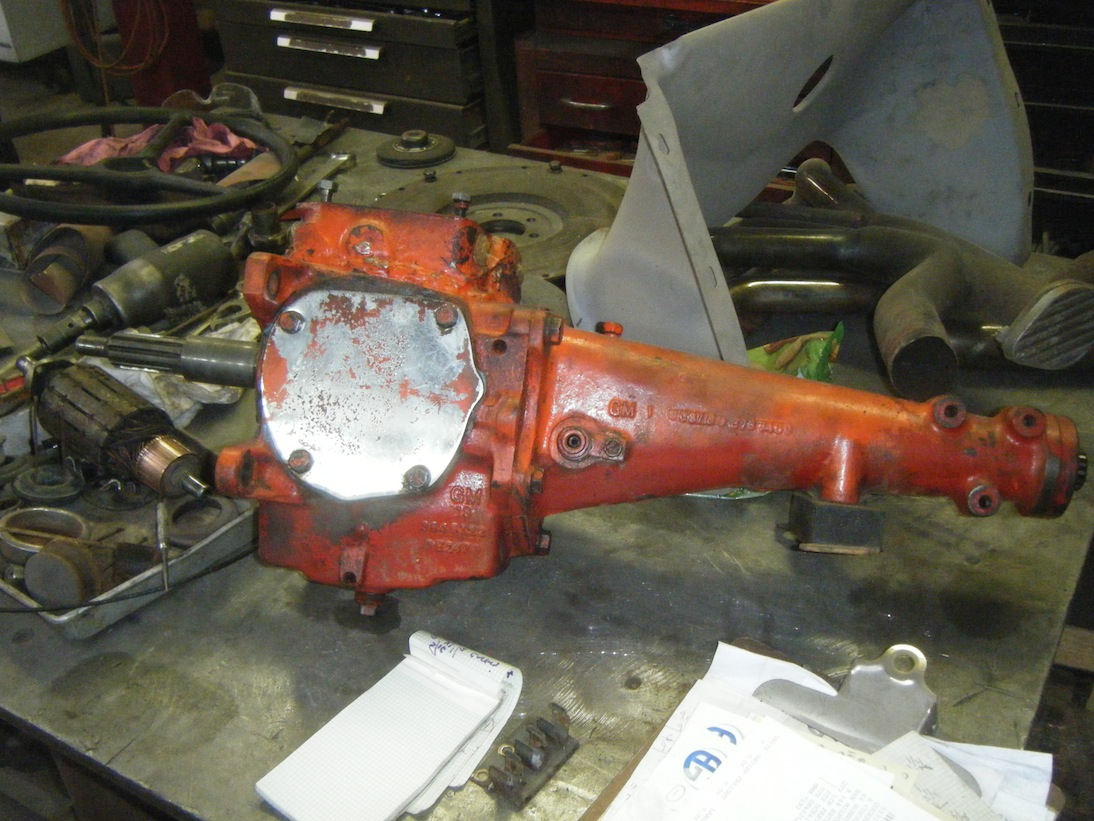

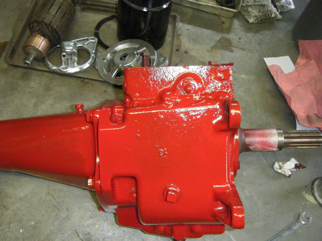

  11. you have the parts to try to replicate what my dad and uncle did, in the fifties. they cut the top off the 37 truck tranny and welded it to the top of the 55 3 speed. DSCF3813.JPG DSCF3822.JPG
    302GMC and volvobrynk like this.

    I remembered that one. But yours is a car transmission? With better gears then mine, right?
  13. first gear in mine is way too high i wish i had the lower first gear.
    volvobrynk likes this.
