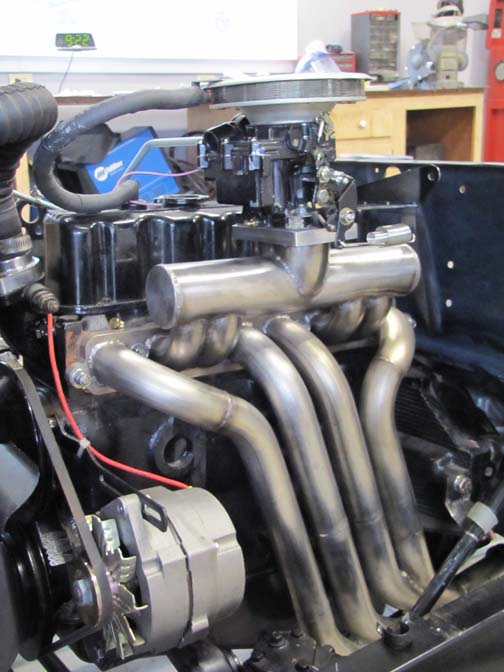

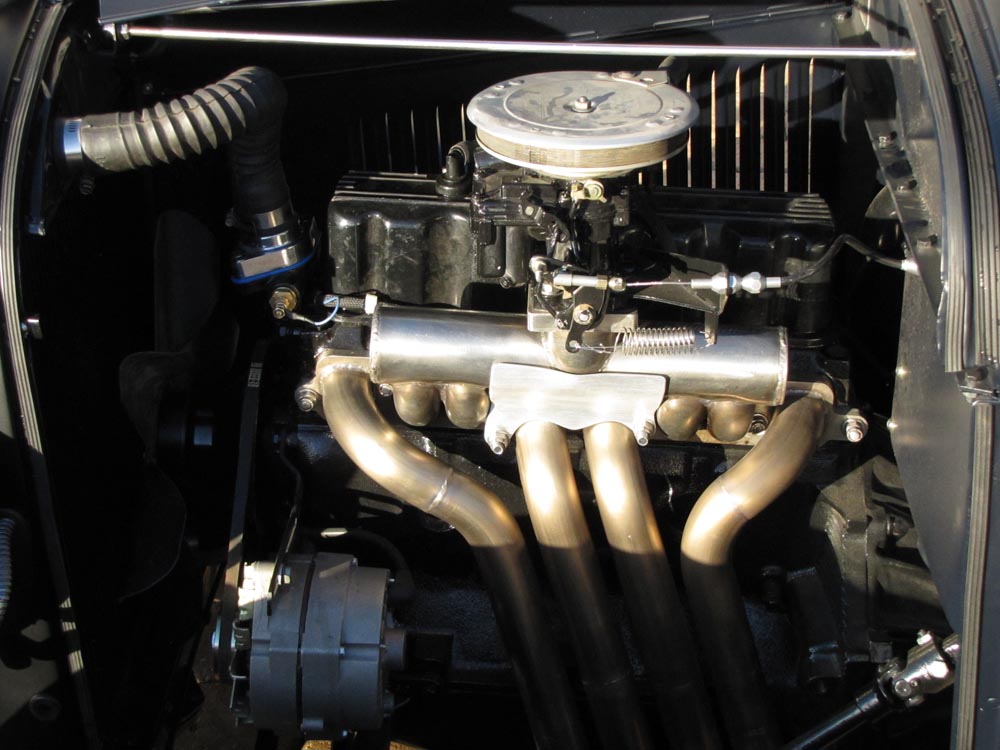

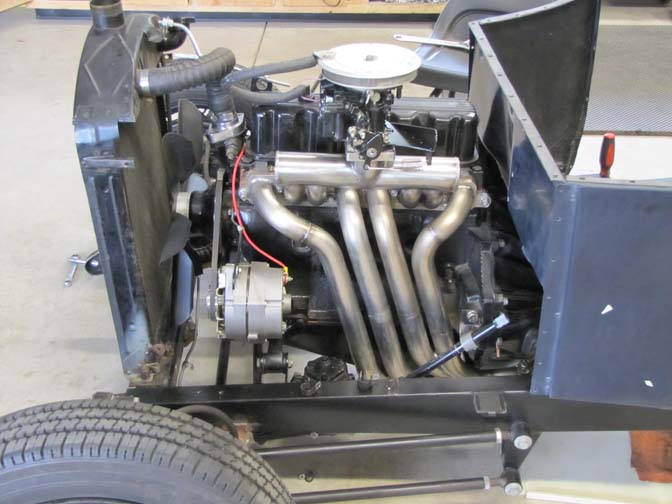

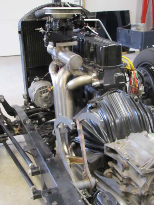

    Here's my Mercruiser in my 'A" pick up. It's a 1985 3.0 liter 181. The intake and header had to be fabbed, plus a heat riser made to heat the fuel mixture, but it runs great! Just hit the highway a month ago. S-10 5 speed bolted up with minor modifications too. Plus I didn't have to touch the firewall or floor to make it fit.

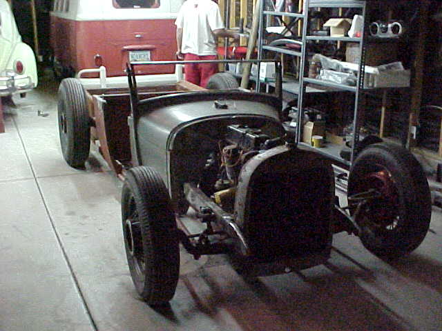

    I built a T bucket in '88 with a 153 block and M'cruiser stuff like the aluminum covers, dizzy and the 181 crank. The cam was an Isky flat tappet. Carbs were two 94's on a scratch built manifold. It had a '50 Ford p/u trans and a '40 Ford rearend. That thing was a rocket! Big surprise to me an lots of others!
