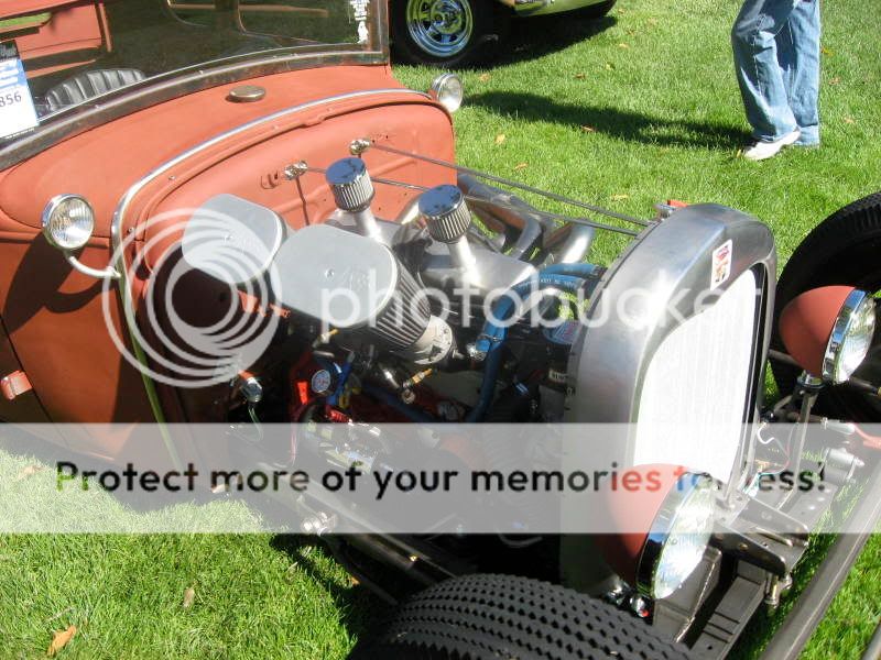

  11. flyin-t
    Joined: Dec 29, 2004
    Posts: 1,423
    flyin-t
    fordnutz, that a great looking touring. I like the skinny whites and baby moons. Reminds me of a car that was on the cover on Car Craft in the late 60's. I'll have to look for that mag.

    Pat: first, beautiful car.
    What would you estimate your HP at? What displacement is it?
  13. Flyin T, the car you are referring to was Monteiro's T on the cover of Car Craft. It was also in the Beach Party movie with Annette and Frankie Avalalon. I saw the car in the movie at 13 and I was hooked. Had to have one some day. I used the 4 banger to be different. I was going for the early 60's look. As for the OMC engine, I think you could get the 153 version from them. It was a factory Chev engine. The mercruiser was a larger displacement, so I guess that is why they outsold the OMC. The skinny wheels are 14x5 late 60's nova and the rear are 15x5 1/2 54 ford station wagon. They fit nice in the fenders. Axle is a narrowed super bell. 67 mustang rear.
    GuyW, Thanks for the compliment. I don't know what the horsepower is but I started with the 153 engine, so 90 hp to begin with. Shaved the head and bored 60 over. That is about it. Pat.
