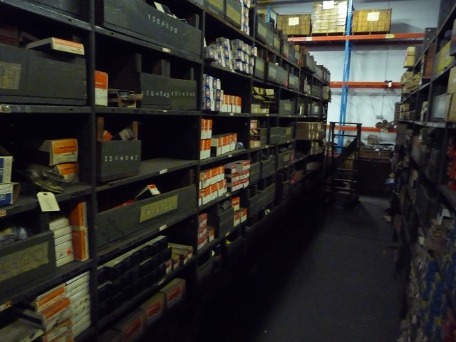

    FYI - Lots of NOS parts will be available soon. 12Bolt also has high performance parts and has done extensive dyno testing comparing different builds with Chevy 6's.
    Information and parts
    http://www.12bolt.com
    Exciting News. 12Bolt LLC has bought all the inventory of GM parts from Studebaker International.
    What does this mean? Back in 1965 Studebaker was using GM engines in their production cars. Inline 6 and V8. This continued into 1966. The parts inventory was maintained and stored all these years.
    almost every part needed to build one of these engines was still available.
    A sampling of the stock. All NOS parts.
    nearly 50 blocks fitted with pistons and bearing.
    50 cylinder heads. Thousands of valves
    Steel shim head gaskets
    50 carburetors and parts to fix/ repair carbs
    distributors
    fuel pumps and repair kits
    Fuel lines
    Kits for every part of the engine.
    It was all packed and is heading to 12Bolt in Iowa.
    There are over 100 steel shim gaskets.
    44 oil pans
    25 distributors
    20 Valve covers
    25 timing covers
    The good style AC fuel pumps 30?
    Rebuild kits for those 100?
    Fuel lines
    Vacuum lines
    Sparkplug wires.
    Every conceivable part for a distributor or a starter.
    Cranks
    Rods
    oil pumps
    main caps
    water pumps and parts to rebuild them.
    Dipsticks
    And the list goes on and on.
    Once it all gets inventoried, the list will go on the website.
    The same goes for the 283 V8 parts.
