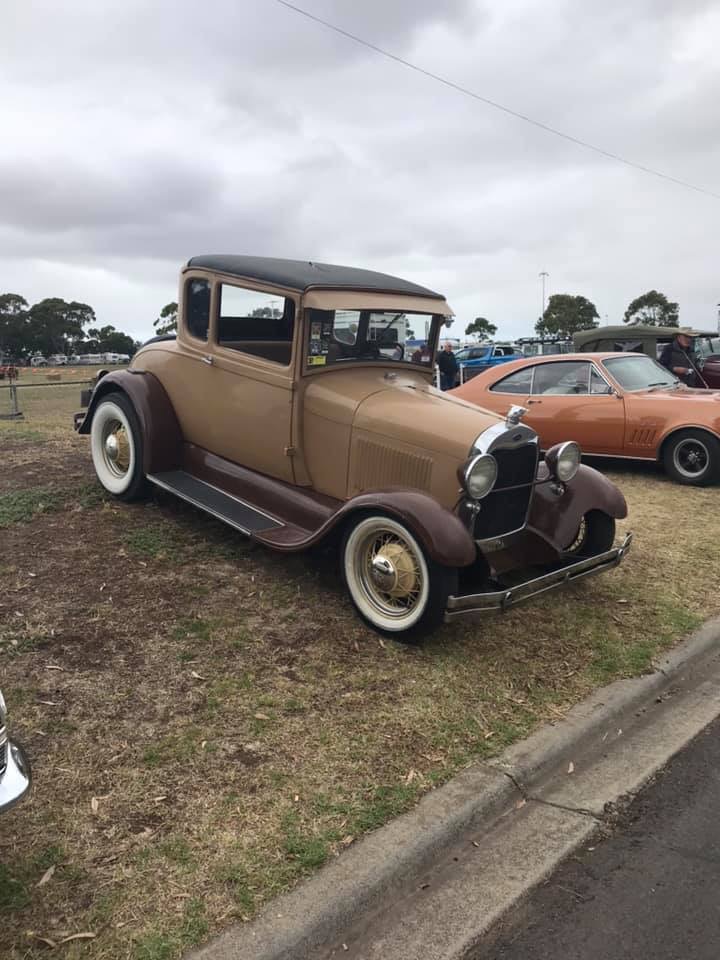

    E5408E48-0969-4BAD-8448-98390C1D4B3A.jpeg Got the coupe back from getting the extractors and exhaust system done ,,because the head was a large port model he had to use inch and five eights tube to best match the holes in the plates ,it’s a bit tight in there now ,,I am completing accelerator linkage and the fuel line with electric shut off and fuel pump from original tank before firing the engine ,,
    29EHV8 and Six Ball like this.

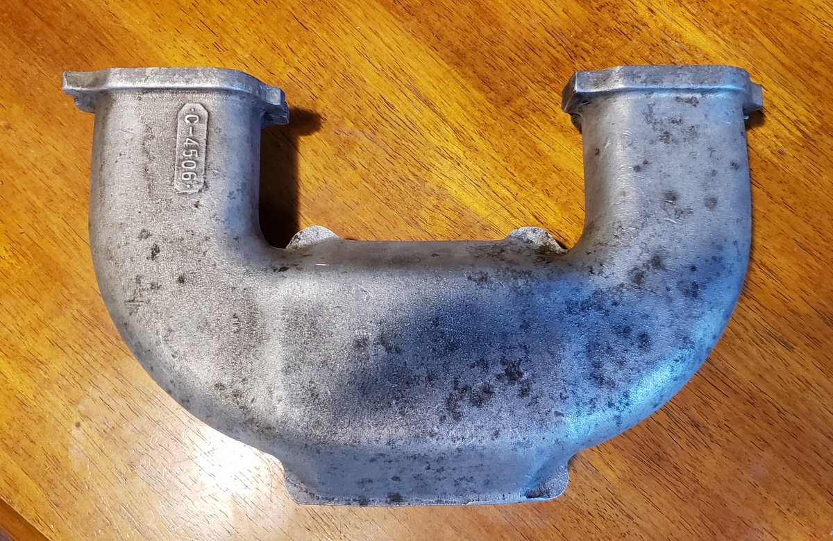

  7. Is Clifford making the 4bbl intakes still? I have one I may sell or trade...
    -Shiny
    Six Ball likes this.

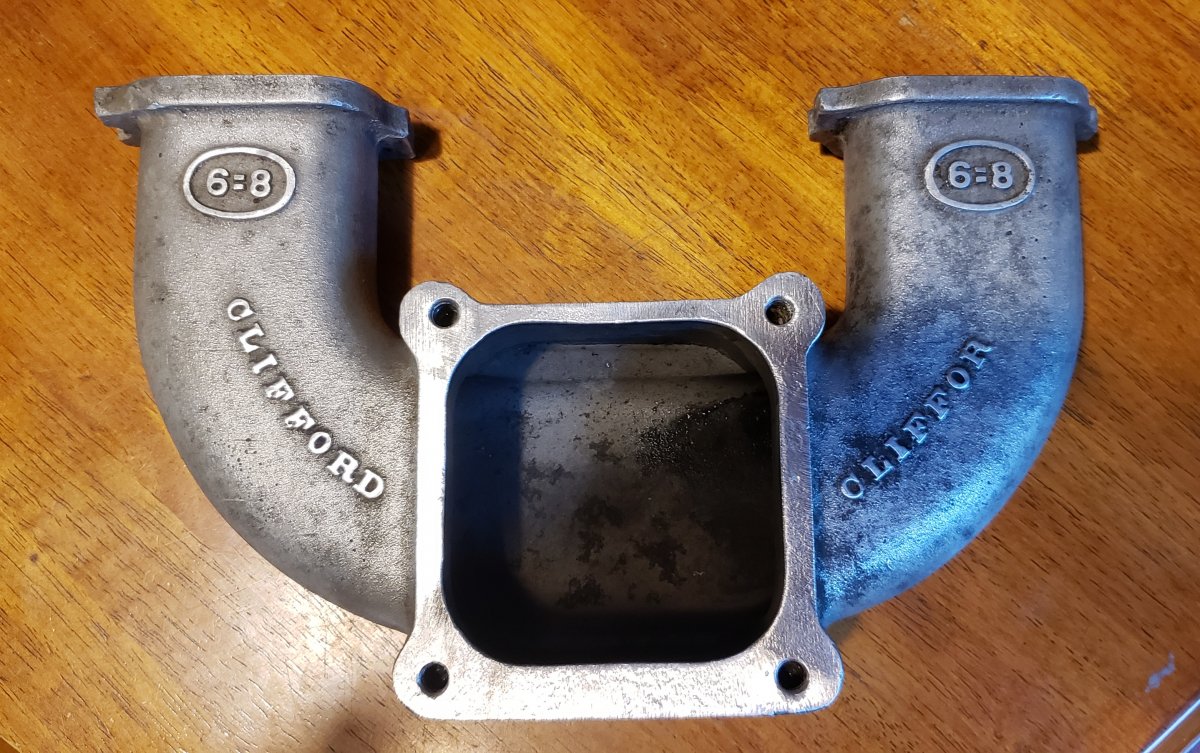

  8. Heres the nice intake I have that I may sell as I am building my own intake...
    -Shiny

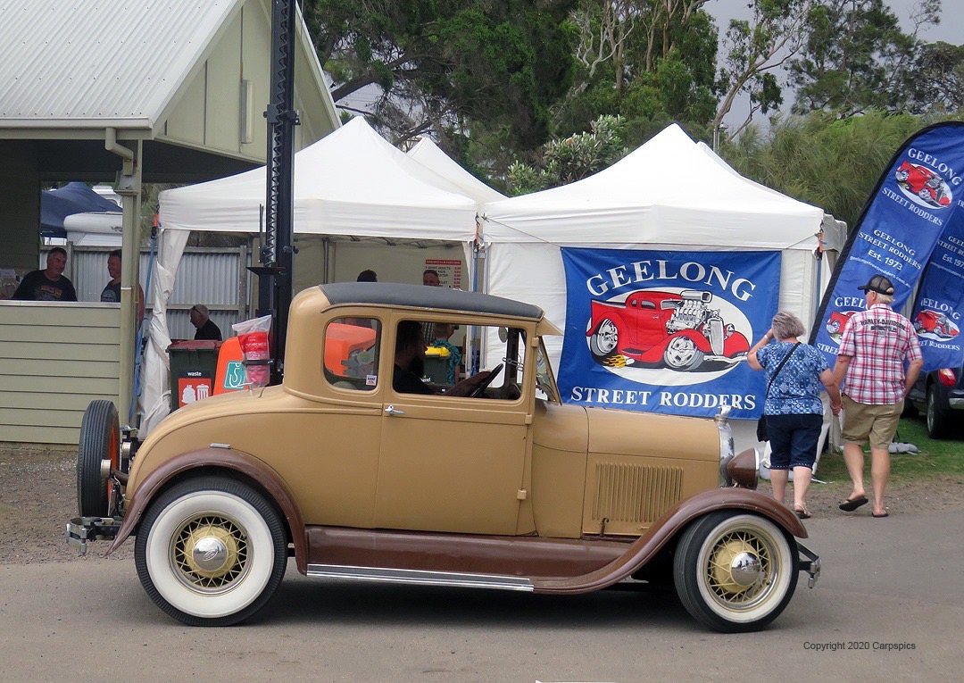

  9. RoddyB34
    Joined: Oct 13, 2009
    Posts: 543
    RoddyB34
    B07E939A-4494-4F85-81E6-753DBE08A341.jpeg FF5AFC41-49DB-43B7-8D6E-B2188DC1D823.jpeg 470C9222-2F0D-4F55-8F0C-C1B49291D069.jpeg Got our 181 mercruiser powered coupe going a few months ago ,,adapted to a 3 speed 3.03 mustang trans and to the A diff through the original torque tube ,,goes great ,,not overpowered but gets along great in city traffic ,,comfortably does 55-60 mph on the highway,,not may people know what the engine is when the hood is up most are amused when you say it’s a boat engine,,,,,

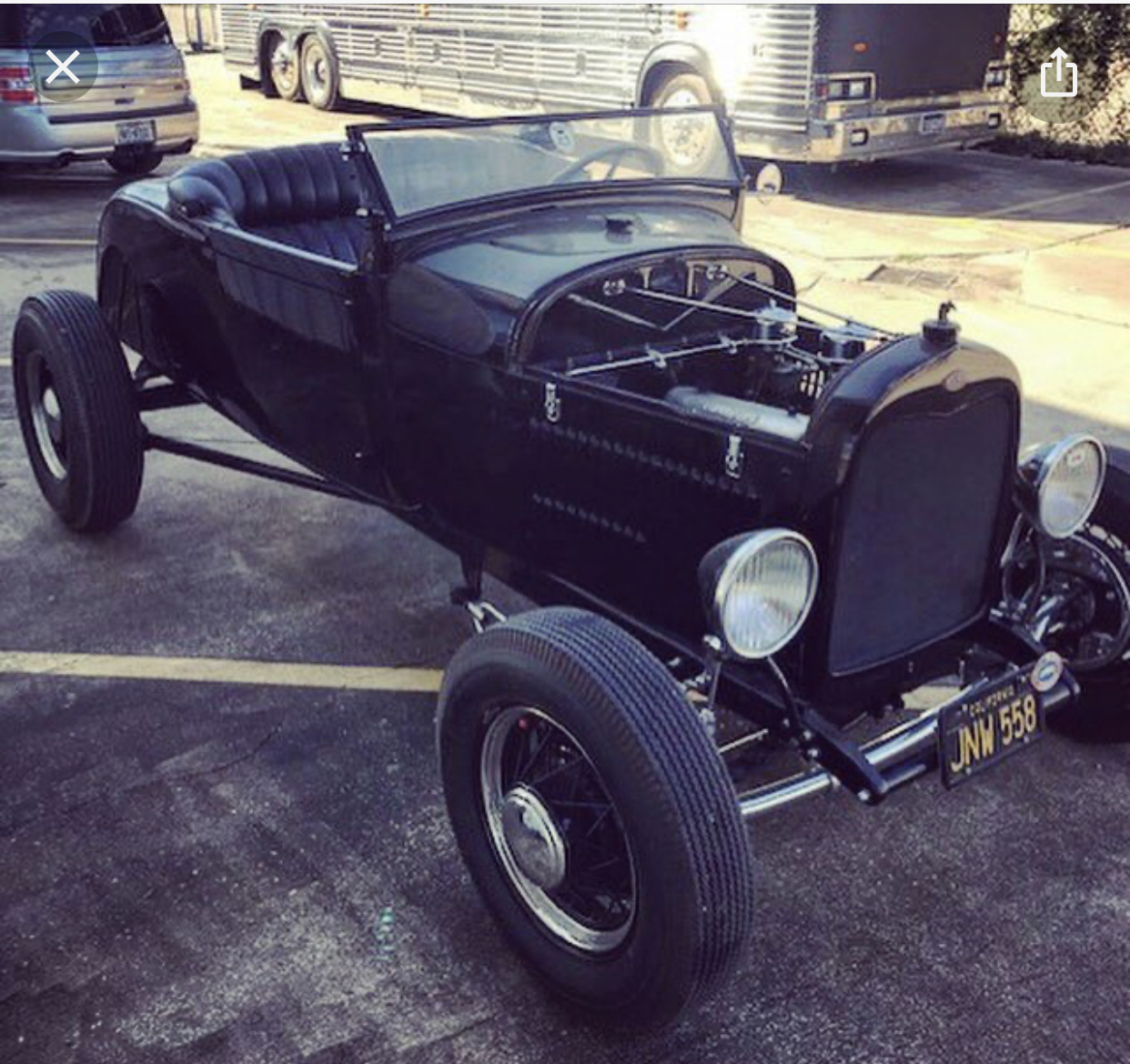

  26. My A sedan would look good with a 153. I could be cool like @Tim ;)
    Six Ball, justabeater37 and Tim like this.

    Brian Bauer’s A-Roadster

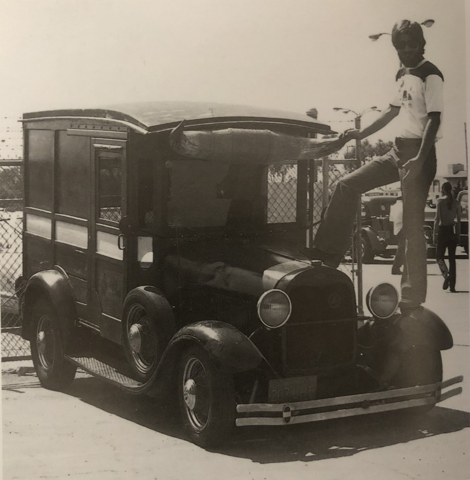

    Jake’s former Chevy II powered mail truck, now Carl Johansen’s SBC powered mail truck. 43299CC6-4F4E-48A1-B5F9-7066876172F7.jpeg
