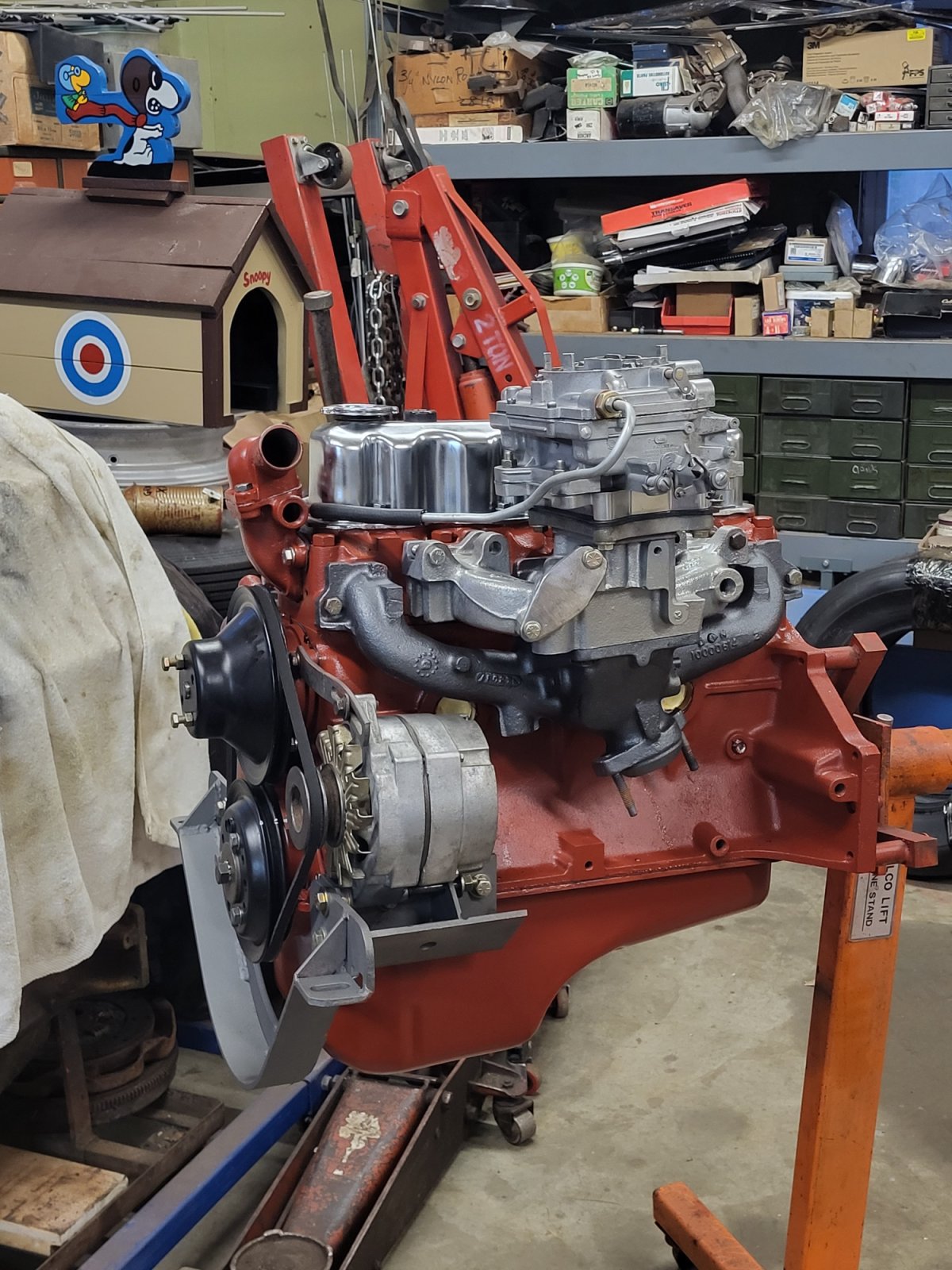

  27. Not sure what stock is, but on start up mine is 40psi and 15 to 20 hot. I run 5-50wt Castrol edge synthetic oil (was Syntec). Castrol said this was designed for flat tappet older engines. I have been using it for over 20 years on all my older cars.
    Was told by a racer friend that 10psi per thousand RPM is normal.
    Bone-Head likes this.

    thanks! Are you running a stock oil pump or a high volume one?
    Mine running hot is around 20. And 10 around idle. That sounds about what you’ve got going on. I thought it was a little low. But maybe it’s ok.
  29. I didn't build the engine, but as far as I know from the builder it has a stock pump. The engine was built a little loose as far as pistons and it has a rattle. I also forgot to shut the fuel off and washed the cylinders down. Does not use oil and runs strong. Has a Rochester 2 jet carb, it runs rich and bogs on right turns. Just got a webber 2 bbl and clifford adapter to change it to.
