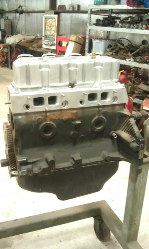

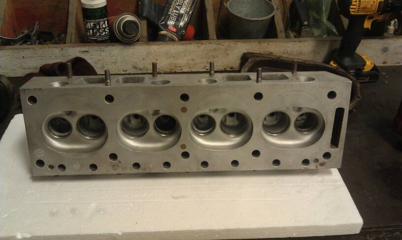

    Anyone on here have any experience with the Ansen Engineering cross flow head? I just bought one on the web. I am going to put it on my 181 I have. It will be going on the coupe. Any ideas on carbs for this setup?
    Drew
  4. Drew.Morris
    Joined: Mar 8, 2010
    Posts: 74
    Drew.Morris
    Here is a few pictures of the head and engine.
    Drew

    This is the first one I have ever seen up close. There was a fontana head on eBay last year but it was big bucks so I couldn't afford it. I just got the Ansen in the mail Saturday so i haven't had a lot of time to study it yet. I am going to look for a set of webers for it. I am also thinking about building a four barrel intake for it. I have a 500 cfm holly two barrel on my 153 right now and it works pretty good. It also gets 19 mpg. The little 153 runs out good but I think I have it over geared. I have a 39 Ford three speed behind it and the stock model a rear. I am thinking about going to a five speed. It would probably run better because this little motor starts pulling hard at about 2800 rpm. Are there any old Ford three speeds with a close ratio out there?

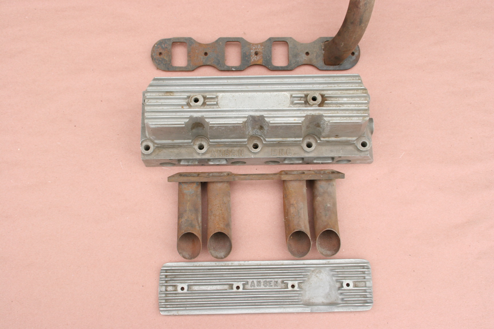

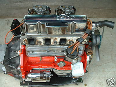

    Some 153 Ansen images.The head with intake and exhaust flanges used to belong to Charlie here on the HAMB.
    The engine with Webers belongs to another HAMBer whose name I have forgotten.
    The block on the table is an EVM engine being assembled in the 1960s.Notice the back of the block trimmed,the mag mounting,the front of the engine as well.I used to have an image of an EVM 8 port head for the engine.If I find it ,I'll post it. EVM was bought out by Ron's fuel injection.I have called to see if anything at all is left for these eninges.NO. Now the source of these pictures was the son of one of the owners of EVM .He posted to the HAMB looking for information regarding a 6 cylinder OFFY clone engine EVM have put together!

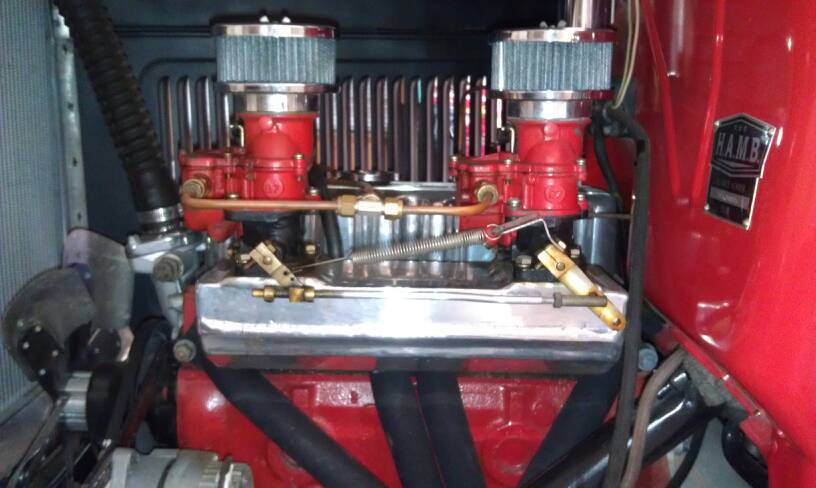

  20. The Weber equipped engine in banjeaux bob's post above is the +.060" 153 in my track roadster pickup. It started out as a Clifford intake manifold which I sliced and diced to fit and added a balance tube.

  24. Bob- I don't know which runner to slice off; mine was a 4 cyl intake to start with. I whacked the throttle linkage towers off and bought a spring loaded Weber specific throttle linkage assembly that mounts to the front carb and operates via a cable from the foot feed. P/N LP1000 from r.d. enterprises, ltd in Quakertown, PA They have a website under that name I believe. It was a little pricey but works extremely well.
    Drew - I'm running a T50 5 speed from a Vega/Monza and an S10 rear with 3.73 gears.
    The Webers work okay but I've never been able to get them perfectly tuned and tip in has been a problem - the transition from the idle circuit to the main circuit.. I'm doing a single Clifford 4 barrel intake with a hopped up Holley 350 2 barrel adaptation to see if that will improve things.
    I haven't driven the car much in the last year as my back is in bad shape and doesn't like the driving position as much as it used to. I'm 6'3" tall and though I worked hard at getting every bit of room possible in the T it is still very tight.
