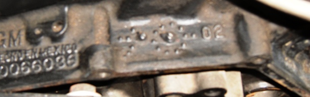

    I have a remanufactured chevy crate engine. I know by the numbers that it is a 350 made in Mexico. Trying to find out the year in which it was mfgd. It does not seem to have the standard date codes that I have read about.
    On the top center portion of the flywheel housing there are 2ea clocks, then a 02. Does this mean anything about build dates?

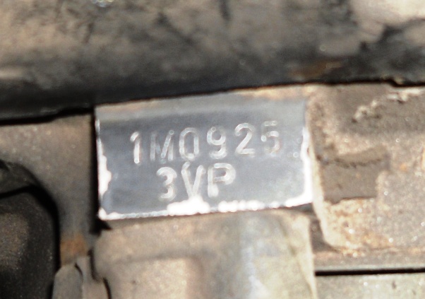

    I will have to go to shop at take a picture. The number on the flat machine spot behind waterpump is IM0925 3VP.
    Lee
  4. squirrel
    Joined: Sep 23, 2004
    Posts: 56,044
    squirrel
    The stampe number indicates it was assembled Sept 25th. Usually the castings sit around for a little while before they're machined and assembled, anywhere from a day to a few weeks.

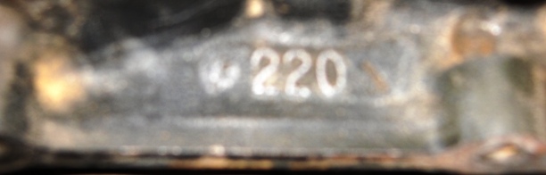

    Thanks Jim. Here are a few pics of the #s.

    I don't know....
    I did see a few things on the internet about the 3VP engines being from the early-mid 2000s. 02 might be the year....or it might not.
    I don't get the clocks.
