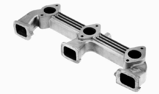

  11. IMG_20141115_142445.JPG I'm looking at running three on my Holden six, which is an Australian smaller copy of the Chev.
    I'm worried it'll be over carbed, so thought about running the centre one only.
    Would rather run all three, and thought I may get away with it by running smaller jets.
    I'm using Aussy Strombergs.

    3 carbs are in theory ideal for a straight 6 with 3 intake ports.
    3 carbs generally help the engine breath better at high RPM, but don't perform too well for a street driven engine, unless each carb is rather small or a 2bbl carb.
    And for a street engine we need a heated intake, especially during the colder months.
    Jet sizes, within small margins, help adjusting for ideal fuel/air mix ratio, altitude and ethanol/gas mix, but a too small jet in a too large carb or the other way around messes with the venturi effect required to get ideal F/A ratio.
    More than one carb slows intake air speed for each carb and jet size alone doesn't compensate.
    kiwijeff likes this.
