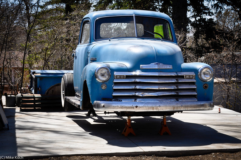

    Last nights progress.
    Drivers side front shock is mounted.
    Peal and sealed the roof in the cab.
    Got a good game plan for building my rear shackle mounts which I hope to work on today after work!!

    And the rear suspension is finally finished!!!
    Got some time this week to weld up some rear shackle mounts and welded them on Henry yesterday after work. I also welded on some square tubing for my bed mounts.
    Goal for the weekend. Get this baby off the jack stands and on the ground and get the bed mounted.
