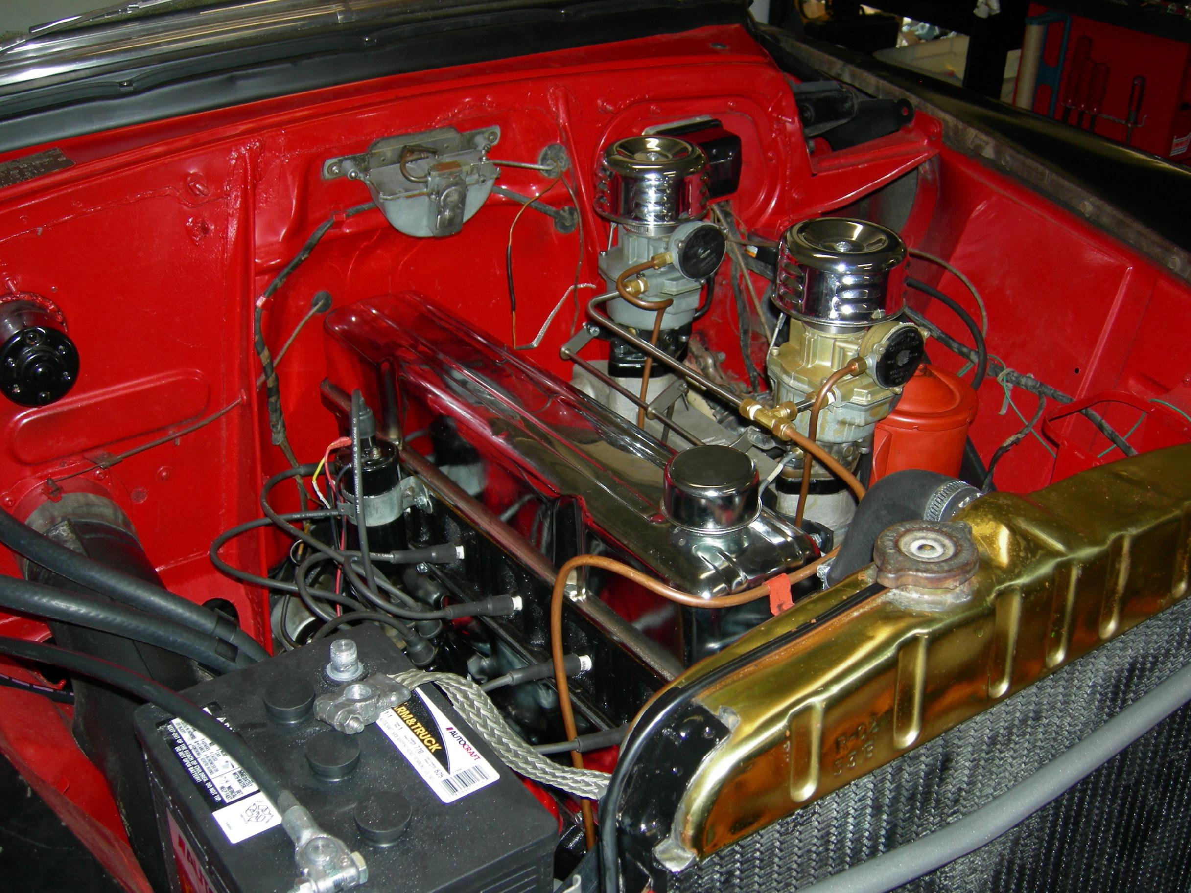

    No work over the last few days thanks to heavy snow and ice, so I was able to get some stuff done on the truck. Its got an inline 250 6 with dual Carter Webers on an Offenhauser manifold. Theres a link to the build thread in my signature....
    Yesterday I finished running the fuel lines from the fuel pump to the carbs. Initially I used 1/4" copper tube, but after some thought and some advice from the guys on this board, I pulled it off and started over with 5/16" copper, I'm using compression fittings to join it all up.

    Using a lot of patience and thinking things through ahead of time as much as possible, I wound up with a pretty good looking fuel system that should work like a champ. I am not 100% happy with the fuel filter location, but I wanted a glass filter housing so I could see if fuel was flowing (and because I think they look cool) and I wanted it after the pump, so this seemed like the best location.

    I'm sorry but that looks too much like bathroom sink plumbing rather than a fuel system. I know a lot of guys think copper tubing looks cool but to me it says that the guy was too lazy to do it right with flared steel tubing.

    I think it is a fine, inexpensive option, and looks good when done right. I put the copper fuel line on as a "temporary" fuel line just to get the thing started, I spent about $12 at Ace Hardware for the materials, took about 15 min. to fab up and worked like a champ! I was going to swap it out for the stainless fuel line I had ordered (pre-bent cost over $40 after shipping) but the wife says she likes the look of the copper. I asked a few others and they like it too, it goes with the look of the car.

    Man, thats cold. You burst his bubble. At least you said you were sorry. I was under the impression you needed to have a coil or something to allow it to flex to keep it from cracking. Is that not the case?

    I bent mine pretty easy by hand, just have to go slow. I have a tubing bender but it was not necessary. Some people have told me to pack it with sand and then bend it, but that seemed like a bit of overkill, not to mention I didn't want to take a chance of introducing sand into my fuel supply.

    As for the cracking, I used a rubber line between the fuel line on the frame and the fuel pump to allow for the engine movement, all the copper is between hard points on the engine that can't move in relation to each other, and its well supported. I'll still keep a close eye on it to make sure it holds up over time.

    If that is a GLASS filter, that is a fire hazard. I have seen some cars burn because the glass filter got hot then splashed with water. The glass burst and shot fuel everywhere!!!!!!!!!

    Oh by the way, where did you find that fuel filter? I like the way it is connected with the fittings. The only filter I have been able to find around here needs rubber hoses, I'd much rather have it connected like yours!

    Its off the shelf at the AutoZone, its only mediocre quality but I think it will work. It came with plastic fittings you were supposed to screw in and attach a hose too, but it took 1/8" NPT ok. I originally got a Mr. Gasket one at NAPA, it was crappy and I didn't use it. I'm keeping an eye out, if I find a nicer one I'll probably replace this one later.

    Just double checked, its a "Spectre" brand, I guess its not teh house brand after all. If yo google "Spectre fuel filter" it will come up.

    I have a similar filter (probably a Spectre, but it is metal instead of glass) in the same location that feeds my custom 3-carb setup. I don't like the filter because 1) it looks like it came from the "shiny crap" aisle at AutoZone, and 2) it visually clutters up the space (I have hard lines running from water pump to intake manifold that also run between water neck and valve cover). I bought an AC glass bowl filter to put in the system but it is a bit too tall to put where I want it. So, for now... shiny crap will do.
    If we're voting on the copper, it gets a nay from me, but as a couple have said, to each his own. It's your car, so you don't have an obligation to my tastes.
    Edit: yep, mine is Spectre as well...

    I was going to go with the glass bowl type filter too, I really like the way they look, but same as you, just couldn't find a place in the line where it would have fit.
