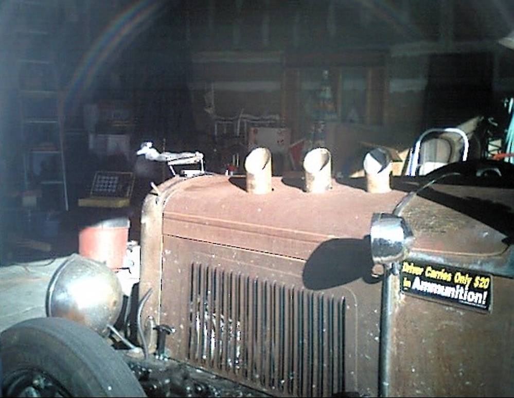

  26. 29nash
    Joined: Nov 6, 2008
    Posts: 4,544
    29nash
    from colorado
    If I had a 230 the only things I'd do to it would help it breathe better with carburetor-thrice and split exhaust. Use the same setup as on my 292 except replace the Monojets with Pot bellies. :D
  27. 66miles99
    Joined: Sep 14, 2010
    Posts: 295
    66miles99
    from Canada
    So with the hood closed those bad boys stick right thru the top?
    I like that look a lot, but not much in the way of a air cleaner is there?

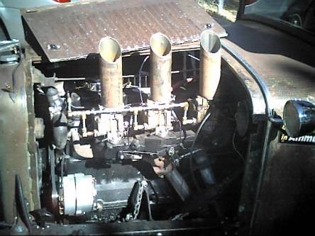

  28. 29nash
    Joined: Nov 6, 2008
    Posts: 4,544
    29nash
    from colorado
    Air cleaner; Two pieces of screen with filter sandwiched in between in each tube. Mesh small enough to keep out big rocks, birds, and such.:D
