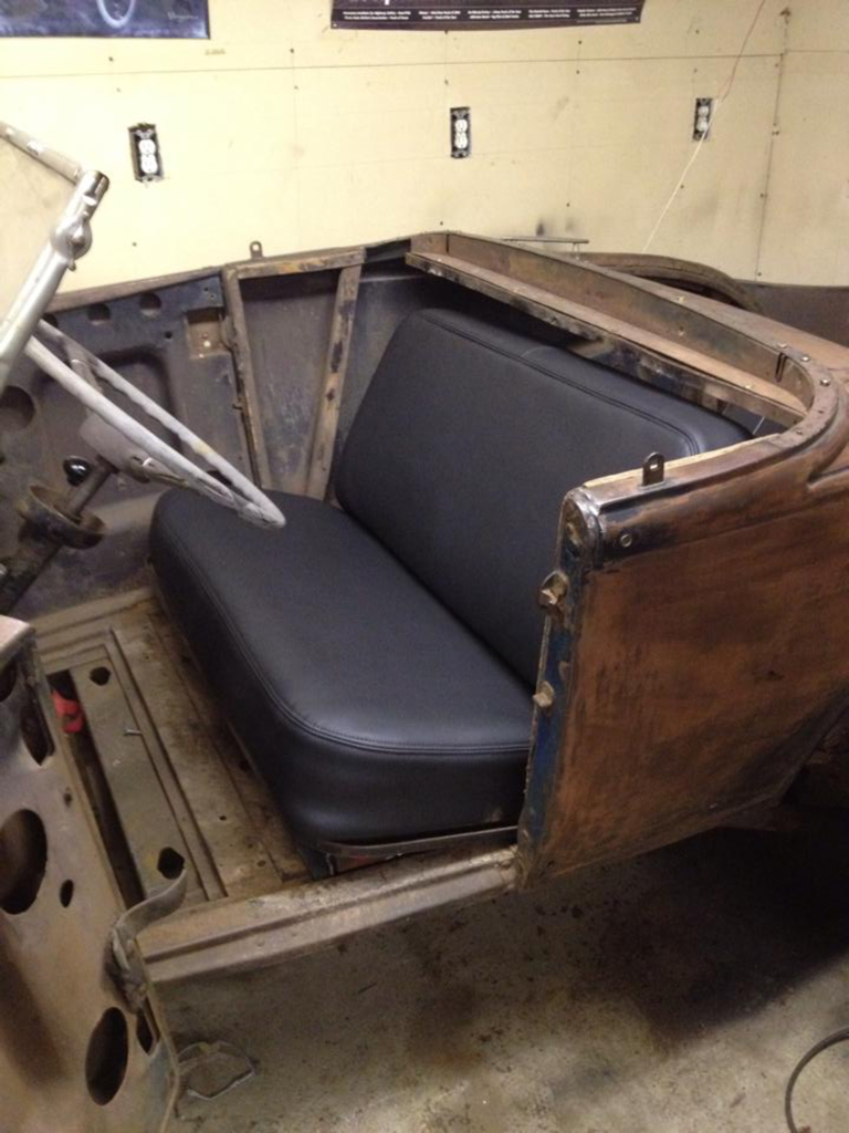

    That's a great looking car! What kind of seat did you use? I have a 1930 model A, and I found a third row seat out of a Honda mini van that I basically stripped and modified the heck out of for mine. The one you have looks like a perfect fit!
  10. Lucky77
    Joined: Mar 27, 2006
    Posts: 2,495
    Lucky77
    Middle row Dodge Caravan, like a 1994. I just separated the two parts of the seat, found the angle I wanted then welded it up solid. It's hinged in front and the whole thing tilts forward till it hits the steering wheel for access to under seat storage.

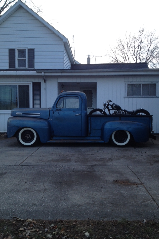

    Do you have a build thread in the f1. What a great pair of projects
  12. Looks like a fun project to me...Kirk Hanning...there's a name I haven't heard in a while.
  13. Lucky77
    Posts: 2,495
    Lucky77
    Not really. I bought it a year and a half ago from a farm out in western MO on Route 66. Flathead seized up in 1976 and they parked it in the barn till I got it. 4" dropped axle from Nostalgia Sid, lowered the rear the same way Kevin Lee did on his F1. New wiring, iPod stereo/iPhone charger, Mustang gas tank out back, new bed floor, and a SBC a Speed Gems adaptor mated to the original three speed. Just a few clutch parts and I'll be firing it up and see what happens. ImageUploadedByH.A.M.B.1423719773.431403.jpg ImageUploadedByH.A.M.B.1423719824.916223.jpg ImageUploadedByH.A.M.B.1423719866.549927.jpg ImageUploadedByH.A.M.B.1423719897.816586.jpg
