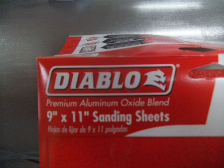

  16. i use this from home depot..it holds up and is on good paper..doesnt rip to pieces after a couple of runs...on the other hand i got some from harbor freight was a cheap price and fell apart..who would of saw that coming....stick with better quality
