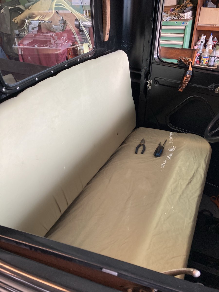

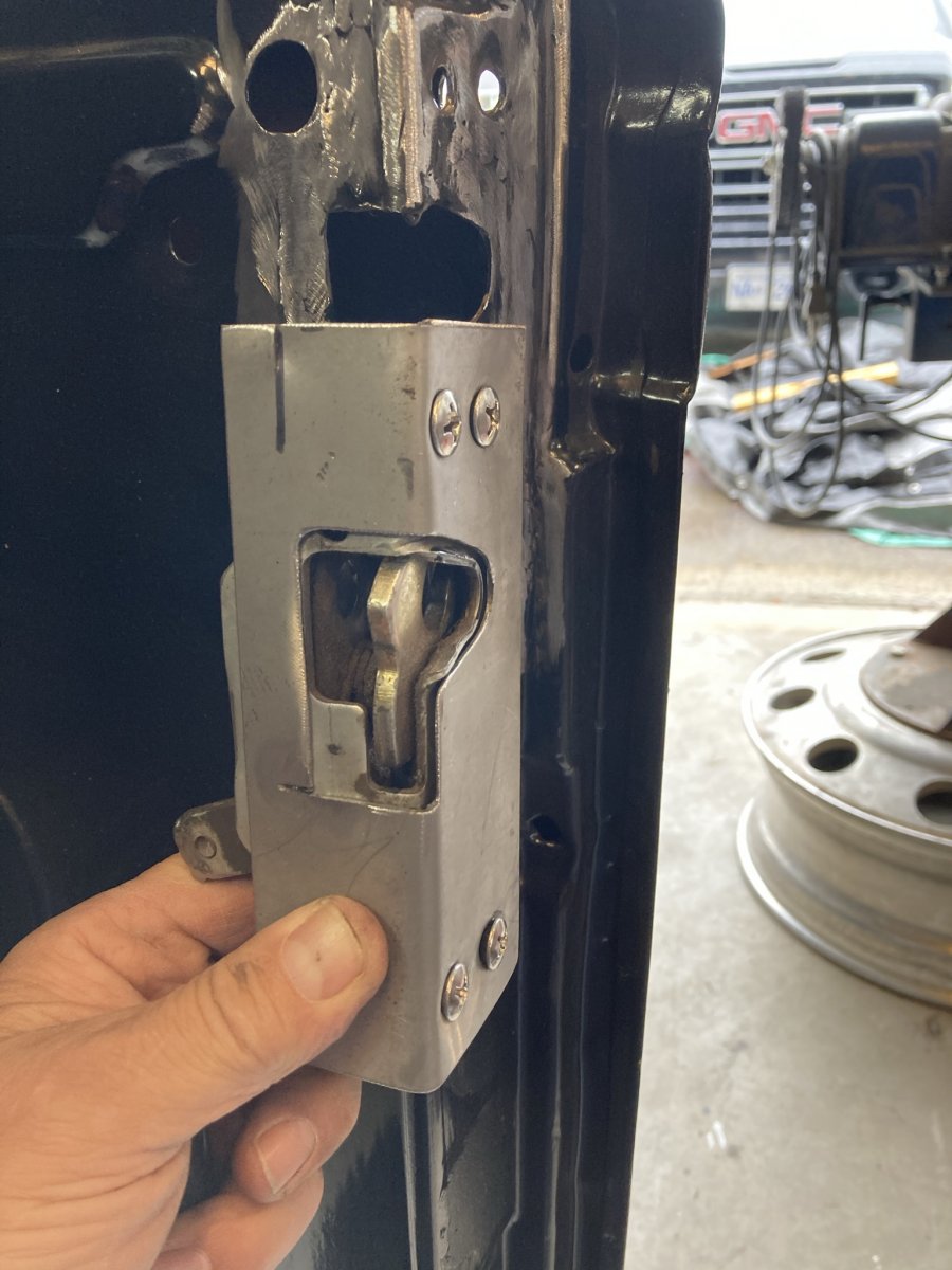

    64358093985__8274B618-343B-45AA-8A18-66CC85FF9E2B.jpg 64359110256__D733BFF5-43F6-4CA9-BFC4-29789329BECA.jpg Crack g to get the truck done before the end of June! Got the seats figured enough to get them to my buddy to stitch the leather on. Most of the wiring done. Hit a snag with the windows, have to move the latches out 3/8" to clear the glass. Boo.
    bchctybob, Okie Pete, Stogy and 7 others like this.
  11. Thats what I was wondering if going to have to do mine...
  12. dumprat
    Joined: Dec 27, 2006
    Posts: 3,485
    dumprat
    from b.c.
    God news is with the latch mount plate flush with the area where the old lock cylinder screw hole is the window clears the latch inside, barely. I cut the fuzzy in two pieces and am going to run a strip of plastic between the two chunks of fuzzy over the back of the latch. Not exactly perfect but should work well enough.
    Stogy, Six Ball and loudbang like this.
  13. guitarguy
    Joined: May 26, 2008
    Posts: 650
    guitarguy
    The seats look good.
    loudbang and dumprat like this.
  14. dumprat
    Posts: 3,485
    dumprat
    from b.c.
    The seats are pretty hard and firm but I think they should soften a bit with about 1/2" of low density foam under the leather.
    guitarguy, Six Ball and loudbang like this.
  15. Runnin shine
    Joined: Apr 12, 2013
    Posts: 3,337
    Runnin shine
    This latch issue is exactly why your paint decisions will pay dividends again and again.
    Tim, Stogy and dumprat like this.

  30. What did you end up doing? I just got my smoked glass today and the latch is playing havoc..
    Also the door handle stem will also be in the way.. Have you test fitted the handle yet?
