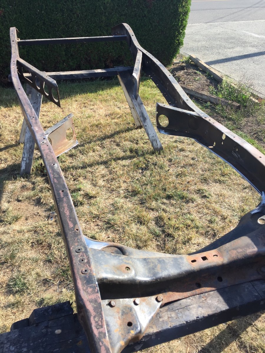

    IMG_3379.JPG There must have been a street rodder manual published that stated you must butcher the shit out of the factory x when installing a 350/auto.
    I picked up a much less rusty but streetrodded frame from a buddy. It has a four bar front and 1/4" boxing plates added. (Yuck) The price was right and I think I can can combine the frame I dropped with this one to build one good solid fame with limited pitting and nastiness.

  6. BuiltFerComfort
    Joined: Jan 24, 2007
    Posts: 1,619
    BuiltFerComfort
    At least they left enough of the X to let you build off that as needed.
    slack likes this.
  7. dumprat
    Joined: Dec 27, 2006
    Posts: 3,485
    dumprat
    from b.c.
    This is the third frame I have had that was cut this way

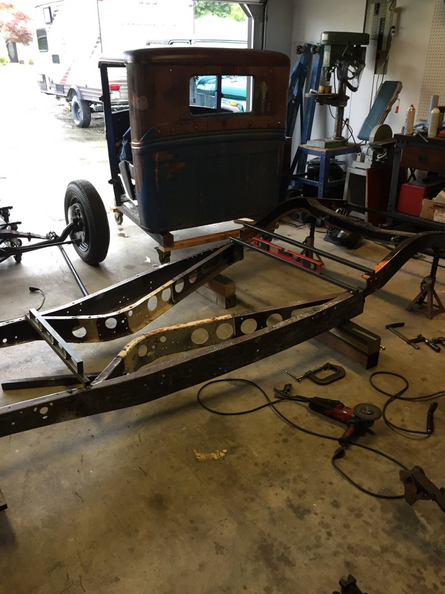

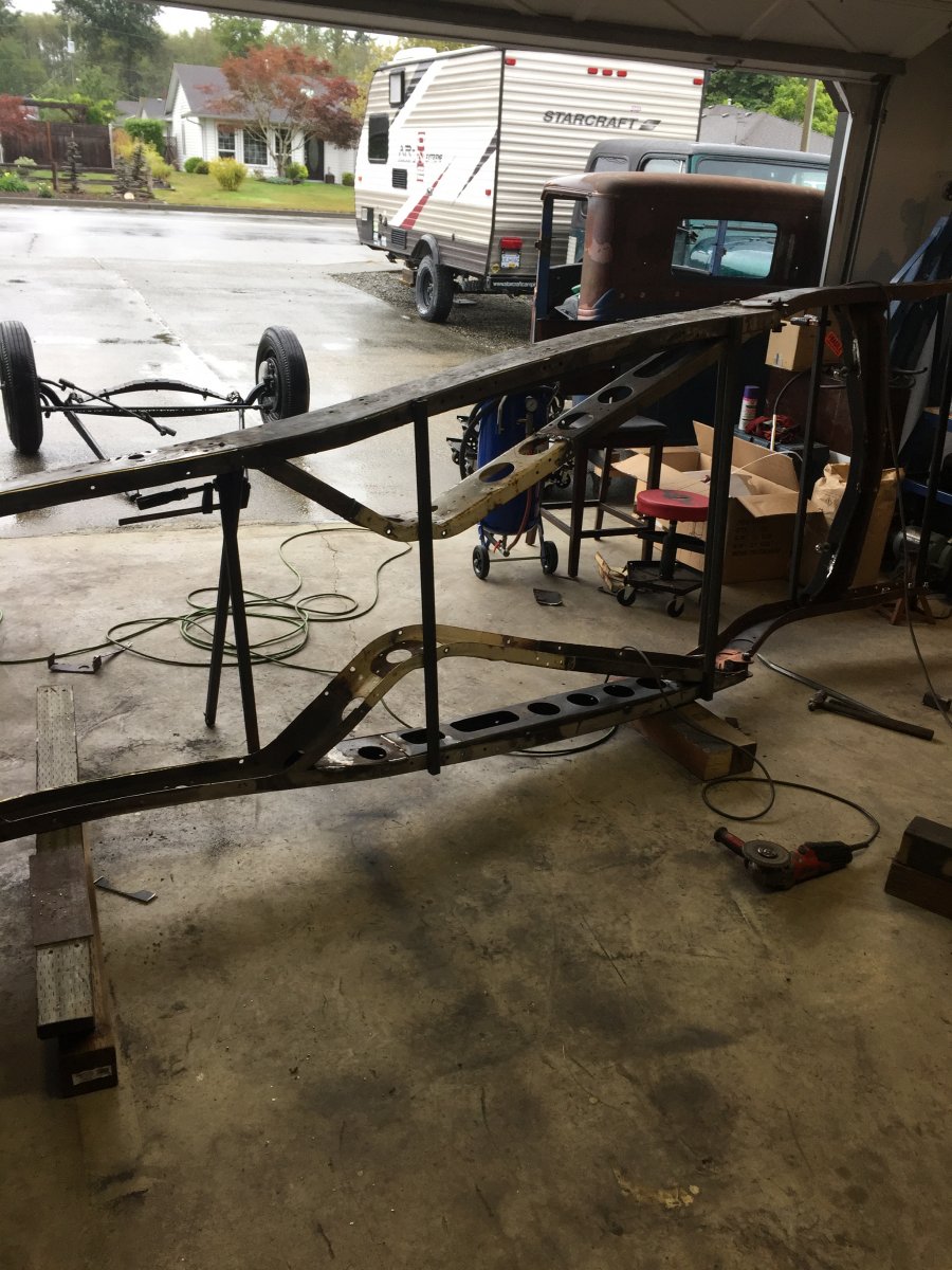

    Today felt like a long step backwards.
    I have the truck fully pulled apart and ground out all he welds on the frame I stuck together almost four years ago. I used the back section of that frame and the front of another that is not rusted through although it has more pitting. I have the new frame tacked to the old rear legs and it squared up as best I can. This week I am going to hammer down on this and get the thing boxed and welded finally.
    For all my dithering, misdirection, and sideways moves I am focused on getting the frame done and in primer before the weather turns .

  18. dumprat
    Posts: 3,485
    dumprat
    from b.c.
    Frame it all straightened out and squared up. Just need to finish welding and add the rest of the boxing plates 9605A0E7-390A-40E0-AE18-AF16AC067B2D.jpeg

    IMG_1586.JPG Ok where are the guys from the tv shows when ya need em? I wanna drive this in an hour! Lol.
    I have the front boxed and finishe welded. And the rear up to the crossmember boxed and partially welded. Spent he weekend eating grinder dust and welding. Might get this part finished up this week. The wife is working 12's at the hospital.

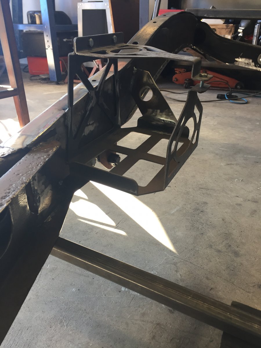

    Battery box mounted, welded and braces installed. Trail gear rock buggy piece I traded for some transfer case parts. I just cut the "TG" out of it.
    I often ponder why when I am hung over and feel like ass my welds turn out great! Cause the rest of the time I seem to be hit and miss.

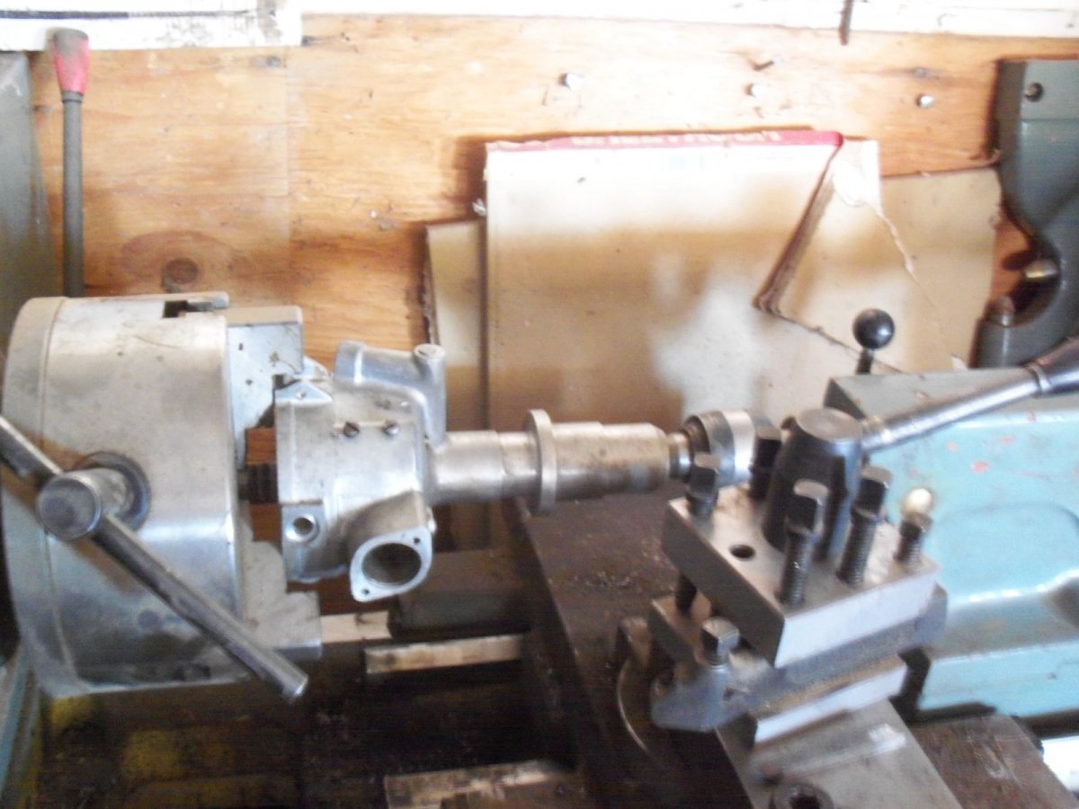

    I'm modifying one for a Pontiac V8 for my Chevy 4. 100_0919.jpg 100_0917.jpg

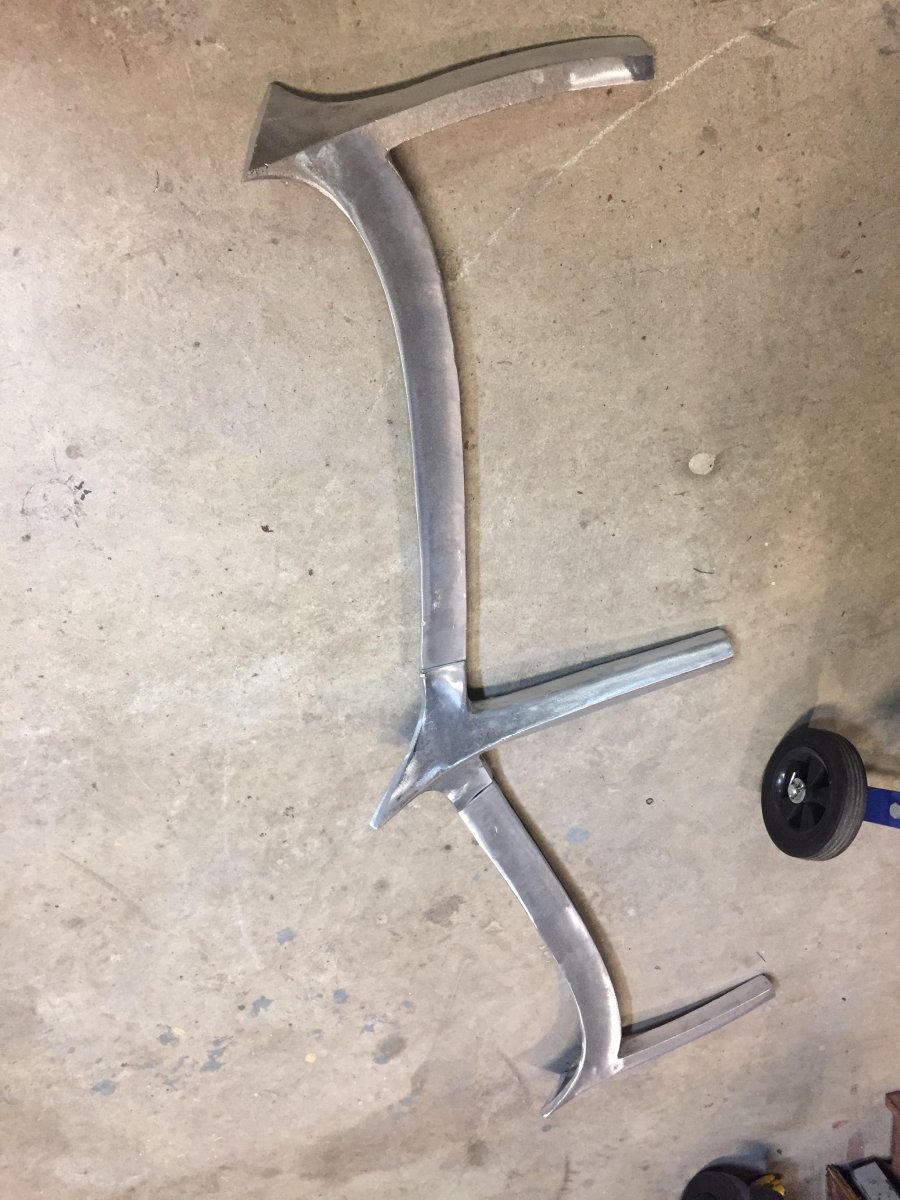

    IMG_1616.JPG Spent the evening building made rear spring bushings? I hope to have the frame back down and the axles back in to set up motor tomorrow.
    I wasted a bunch of time today cutting and grinding the casting flash off the windshield frame for my roadster. I think it has potential.

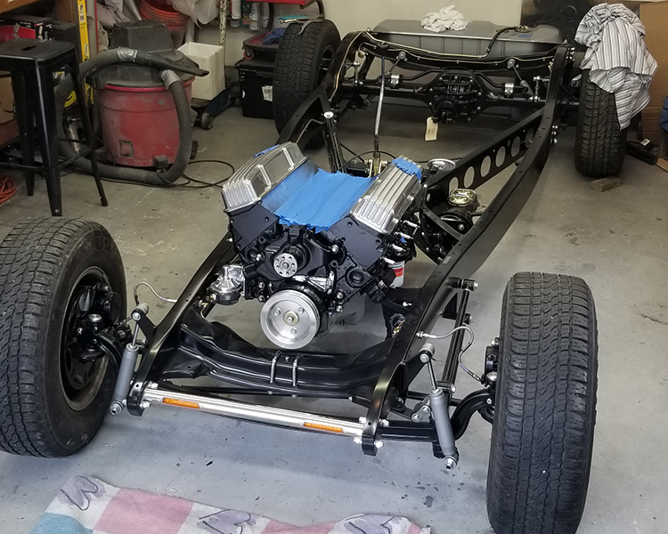

    IMG_1636.JPG My lovely wife has the garage plugged up with furniture she is repainting so no grinding or welding.
    So I spent much of the day fooling with putting the front end and motor bits on to make damn sure that everything is going to fit. And low and behold it does! I do have to move the genny to the passenger side or solder a new top outlet on the road but that is pretty minor.
