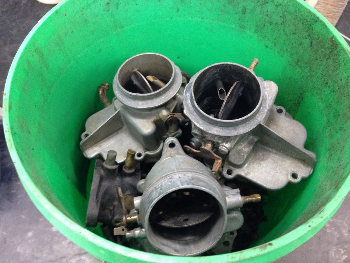

    from b.c.
    image.jpeg Been busy with work family and getting ready for camping season. And I needed a break from sheet metal work and @Running shine posted such pretty pictures of his carbs and intake I felt bad and needed to measure up.
    ( honestly I got three parts carbs at the local swap and need to get the intake figured out so I can see if my hood will clear)
    Mmmmm sleazy carberator bits!

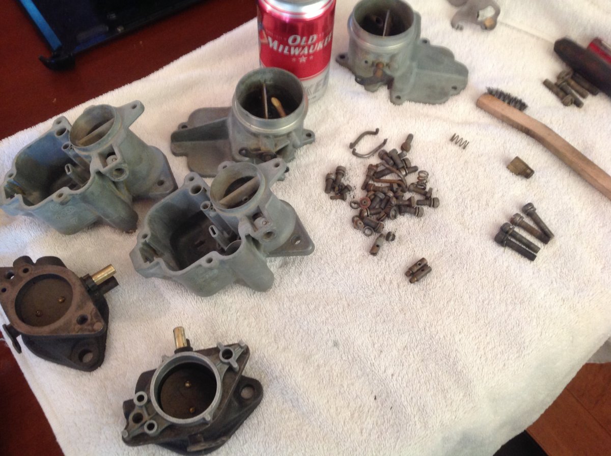

  19. dumprat
    Joined: Dec 27, 2006
    Posts: 3,485
    dumprat
    from b.c.
    image.jpeg I alodine do the zinc parts and am now sitting with a beverage doing assembly.

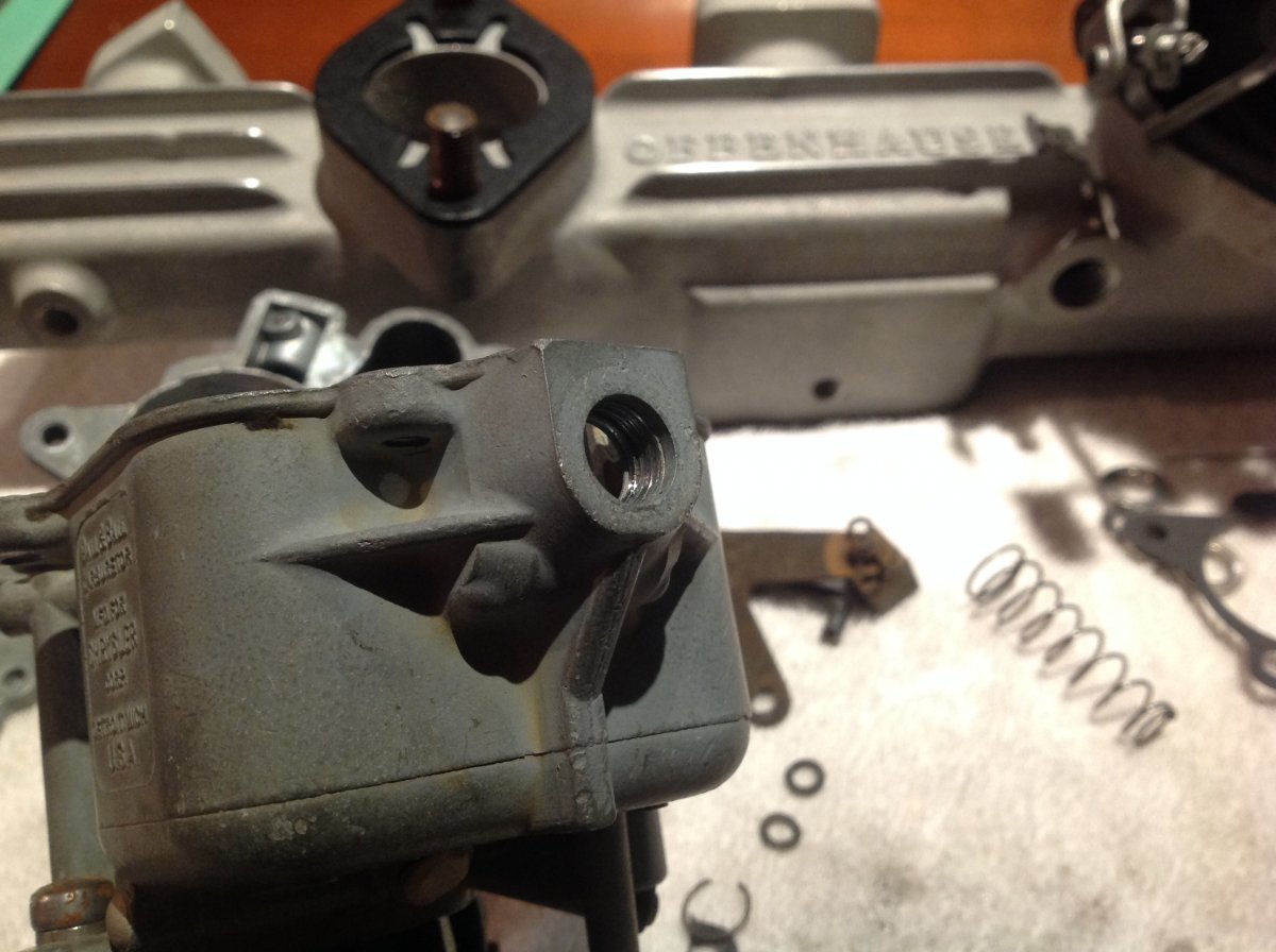

    from b.c.
    image.jpeg Crap! Anybody have a carter 1bbl ball&ball 0-635 carb body they wanna part with? Threads looked ok but pulled right out when I threaded in the needle and seat.
  22. 64 DODGE 440
    Joined: Sep 2, 2006
    Posts: 4,422
    64 DODGE 440
    from so cal
    Looks like time for a helicoil.
    ratrodrodder, Stogy and volvobrynk like this.

  25. dumprat
    Posts: 3,485
    dumprat
    from b.c.
    image.jpeg image.jpeg All fixed up and buttoned up and ready to test fit to make sure I can make air cleaners that will clear the hood easily.
    Carter carbs sure are crap though! Something wrong when you need a hammer to install parts on a carb.

  29. jerseyboy
    Joined: Jul 17, 2006
    Posts: 634
    jerseyboy
    Dumprat,
    What did you clean the carb bodies with? They look good.
    Runnin shine likes this.
  30. dumprat
    Posts: 3,485
    dumprat
    from b.c.
    Jeff. They must be run together like a two barrel. I found with my 251 flat six the end holes run lean and centers run rich with one carb.
    Jersey boy. I soaked the carbs in pine cleaner(knock off pinesol) then blasted them with recycled plastic, which works awesome! Then soaked them in alodine and water for two hours at about 1:20 water mix.
