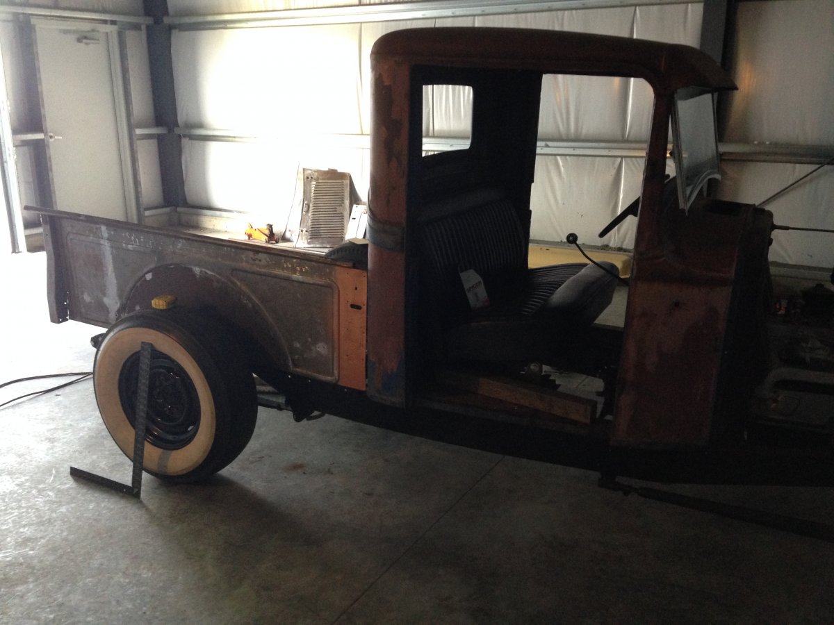

    image.jpeg Still picking away at the truck. But coaching junior track takes up a lot of my free time.
    Got the doors blasted and ready for patches. And the rear spring hangers notched in and tacked up. It now sits as it should and lines up pretty nice. I am going to ditch the 5.00-16's for a pair of 6.00-16's.
