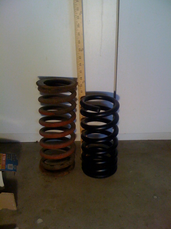

    So any update on how the new astro springs settled? Could you take a 3rd photo and measure it again? Thanks

    Just installed the aerostars a couple days ago with 4" blocks. I've been driing around without the front shocks and the front drives pretty nice so I can't wait to install the new shocks.

    Just a heads up for 49-51 Mercury owners using the Aerostar coils and are considering additional drop using lowering blocks up front. My recommendation is do not use the lowering blocks with Aerostar coils. In the picture below I have a 1" lowering block installed, but the Aerostar springs are too short to seat properly when the suspension is unsprung. The springs don't stay in place. I removed the 1" lowering block and now the coil spring is snug when the suspension is unsprung.
