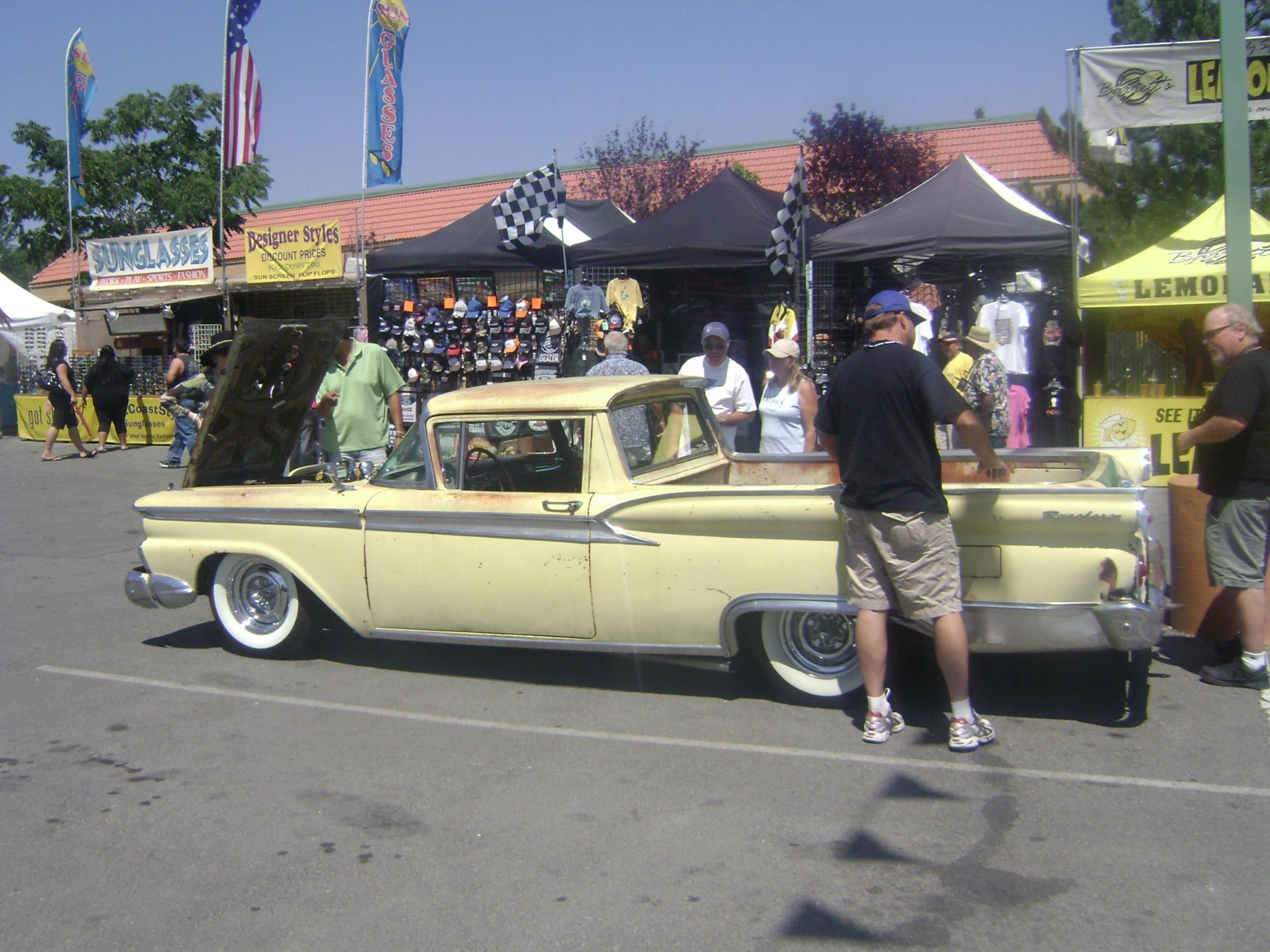

    I put the Ford Aerostar springs on my '59 Ranchero and many hundreds of miles. I like them. Nice and low and they ride better than the stock springs with 1.5 coils cut. Plus they are inexpensive!
    Mike

    The coils improved the ride of the ranchero so much I did the fairlane as well.
    My fairlane runs a 390 auto and had a sloppy ride into the corners. That's all cleaned up now. It's 3 inches lower ( 4 inches in rear). Here's a before and after... ( I stuck me in to give an idea of ride height, I'm 6 foot).
    If you're thinking of doing it.... do it!
