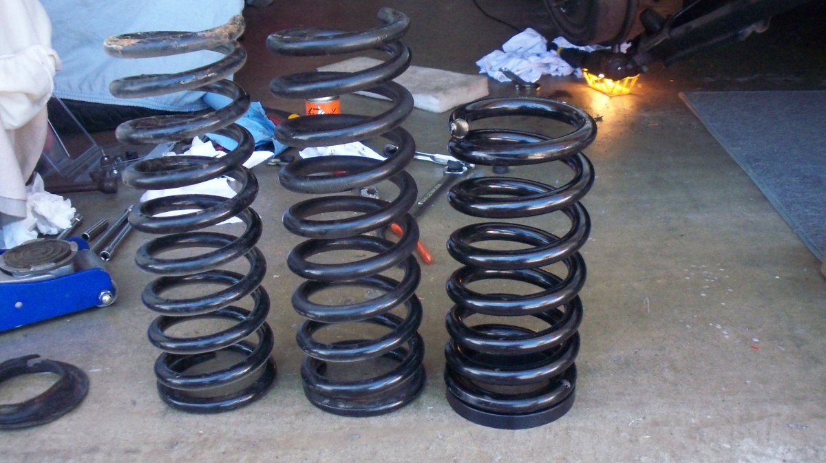

  1. Couple of shots with the CC850 springs... too low for my car.

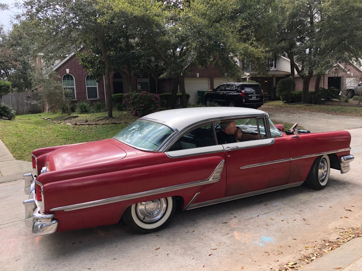

    55 Merc w/Aerostar springs. Havent touched the back yet. Shes sitting real low im almost scared to drop the rear its hard enough to clear the angle of the driveway already
    The second pic is about 6 months after new springs, think it dropped another inch from top photo to bottom

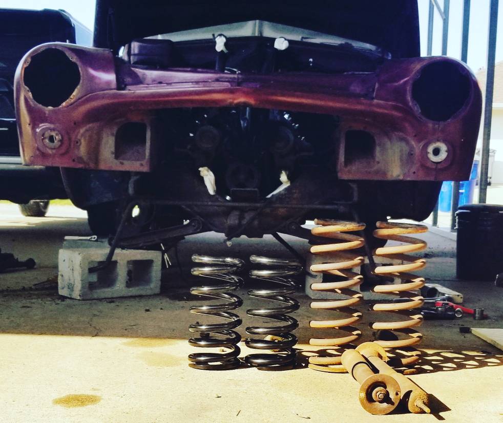

    I'm taking the plunge..going with the aerostars on my 1950 Merc...had to disassemble everything to get it cleaned up..it appears this thing was buried a sand dune for some time.. the aerostars are about 3-4" shorter than the stock coils.. IMG_20201006_162504_423.jpeg

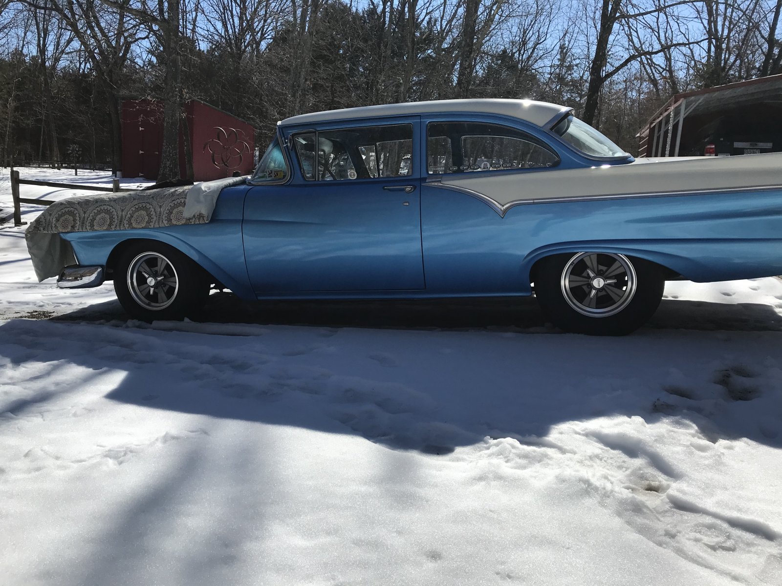

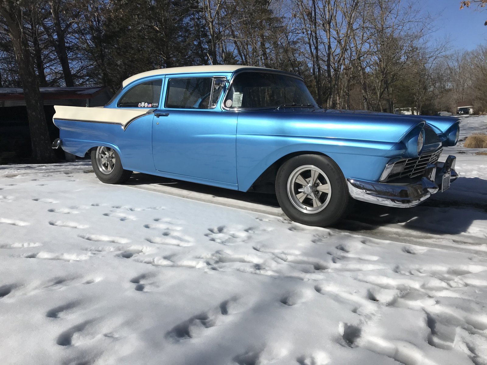

    All, following the earlier comments in this thread, I installed Aerostar springs in the front of my 57’ 300 sedan in the spring of 2019. I rebuilt the entire front suspension with stock replacement parts. The rear springs are original and need new bushings. The rear looks high in these pictures but it is the slope of my driveway. I like to not see the top of the tire-no open space above it. One inch of my front tire is up in the well and no rubbing on turns or angles. Rear 235x75x15, front 225x75x15. 351windsor with aC-4. Thanks for all of the input on this thread. It drives and rides excellent. B2443AFC-D19C-4ECE-B841-A73EBFB057E7.jpeg 6A51CD36-C34A-4810-B14E-707245E04918.jpeg

    Perfect rake for 50’s cars. I’m not a fan of level low…all Fordswill sag in the rear over time. They are a long spring.
