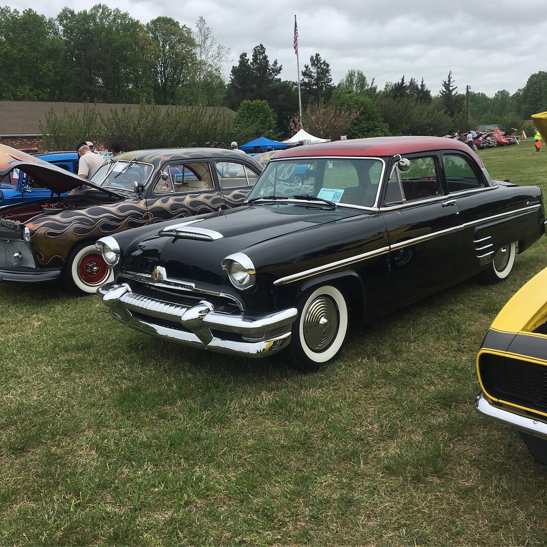

    IMG_0442.JPG Just put a brand new set of Aerostar springs in 54 business coupe last night. They give the car an awesome stance. Lowered the car 2.5 inches for only $53! Awesome thread. Thanks

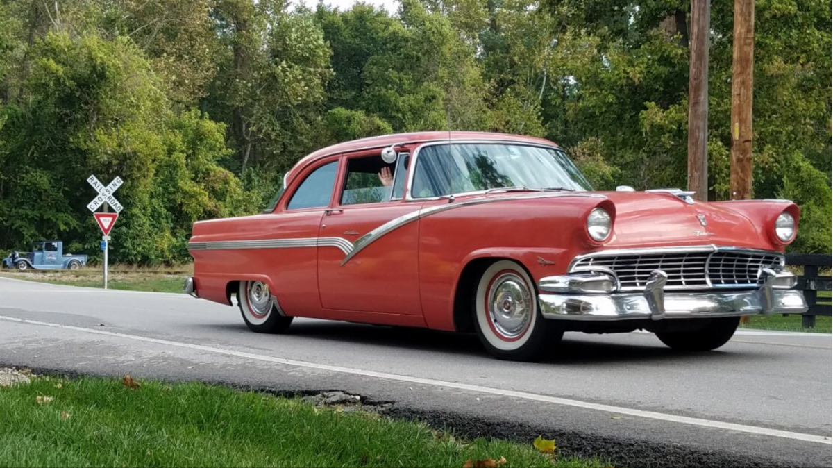

    image.jpeg When I did my 56 there were thin pads on the top of the springs, I'm sure this was for noise. After installing the Aerostars I noticed the car was not level. I had used 1/4" urethane spacers I found on line for a Toyota pickup (same inner/outer diameter as the springs). They came in different thickness so I bought another set and put a thicker one on the lower side.

    Oh, and I don't think I have ever posted a pic of my 56 with the Aerostar springs and 2" blocks in the rear for reference for anyone considering doing this. I have been happy with mine in both stance and ride.

    Looks great!

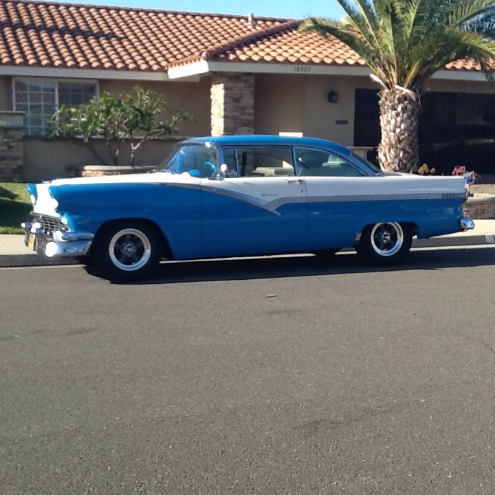

    IMG_2553.JPG by the way here’s mine with aero star springs and 3 inch blocks

    PERFECT stance!!
