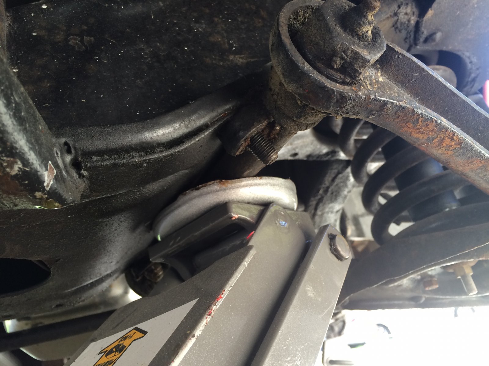

    image.jpg image.jpg There's an easier way to put the coils in. I removed the four bolts holding the inner part of the A-arm to the frame. A lot faster and you don't need to take the ball joint apart.

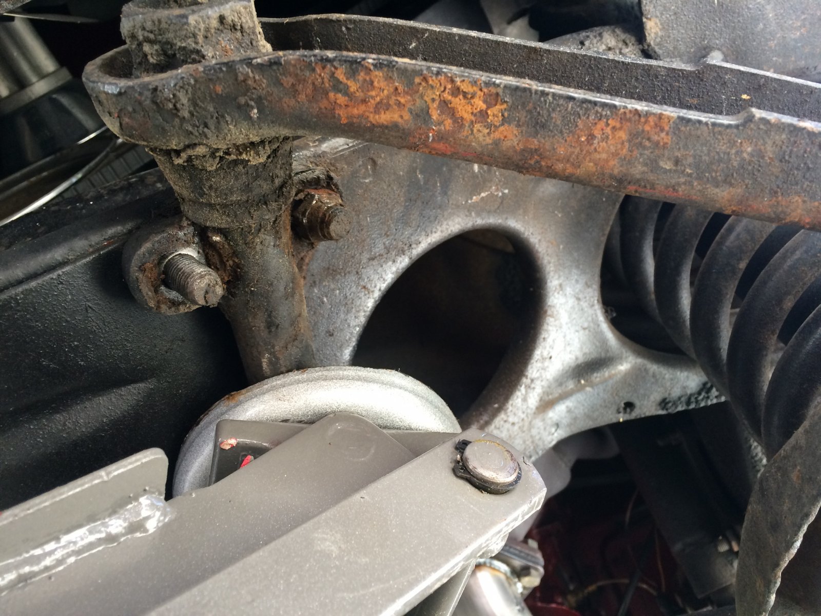

    To add my piece of advice here, on my car someone had already gone at the rivets on the passenger side with grinder and a drill, doing a piss poor job. I used a 90º drill and 3 progressively larger drill bits (in my case 5/32 to start, 1/4, and finishing in 3/8) dipped in oil occasionally and it made quick work of the rivets. Replace with hardened 3/8ths nuts and bolts. Provides great access to the the front springs. I know many have gone this route, I did simply because someone had already started down the path, but it works well. Here is what you end up with.
