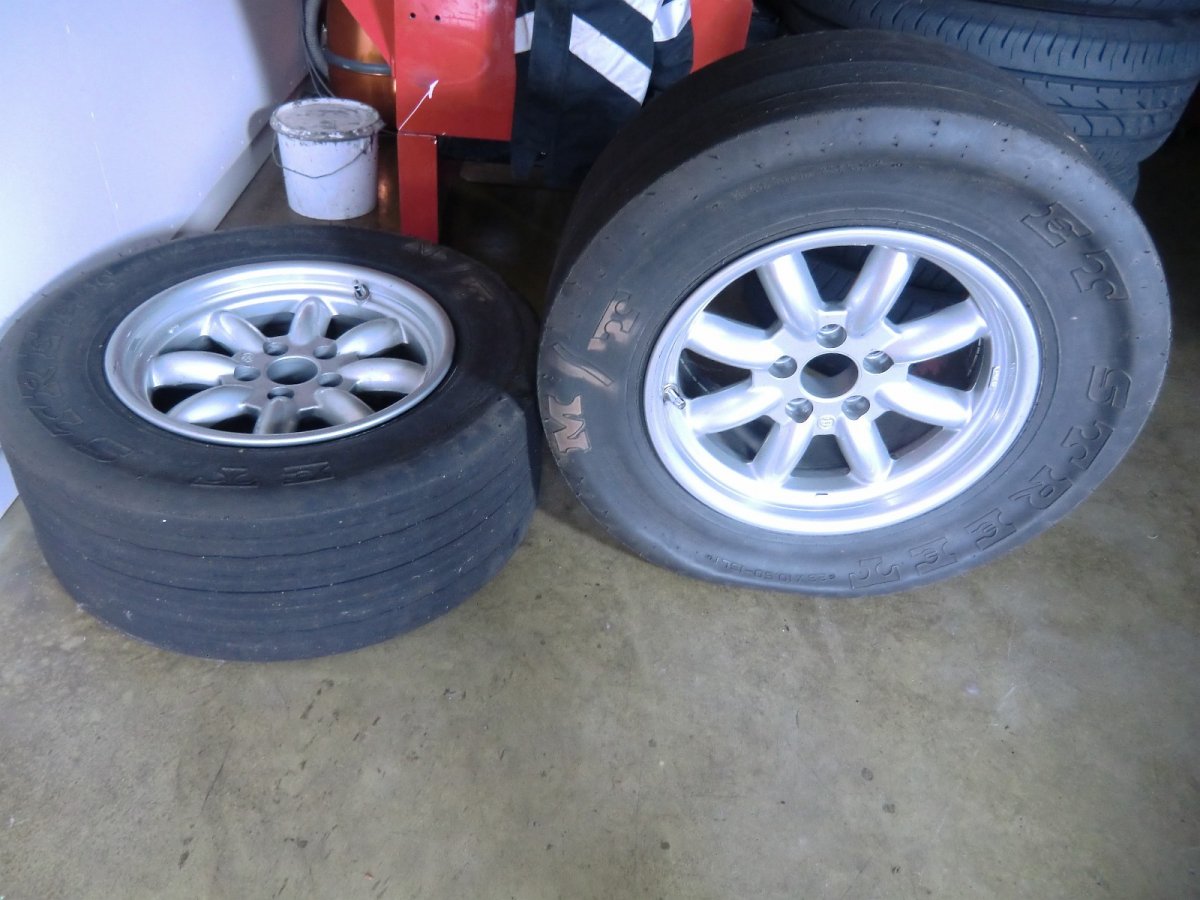

    from norway
    Found a nice set of 15x8" Minilite wheels :) With these, and the Volvo axle, the max width of the rear wheels should be around 60" - not that bad. I will use the bigger tires though..
    Btw, these wheels was used on a Ford Escort with 1030hp (turbo Cosworth engine), with the same Volvo axle as im using. So i guess it should hold up quite good.
