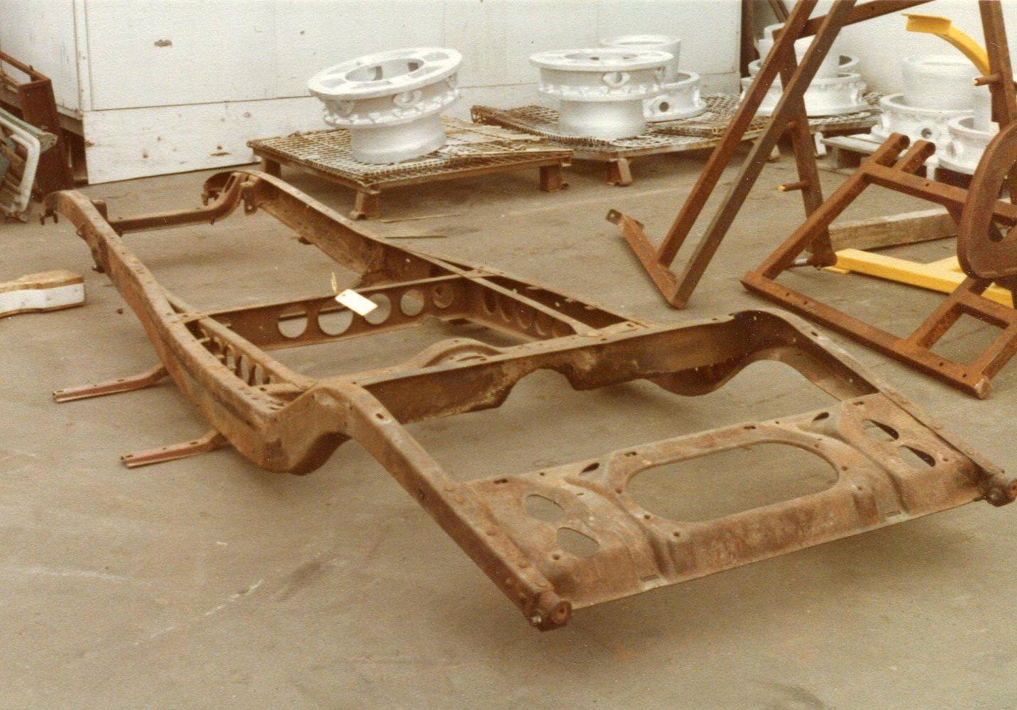

    Trying to decide on Chassis Saver or Powder Coat on my 37 Roadmaster frame.
    Would love to hear pros and cons of each.
    Thanks.

    Joined: Feb 10, 2008

    Thanks everyone for your feedback. Since I'll have a clean sandblasted frame I'm leaning towards powder coat or epoxy primer + paint. It would actually be cheaper for me to have it powder coated since I'm not doing the painting myself.
