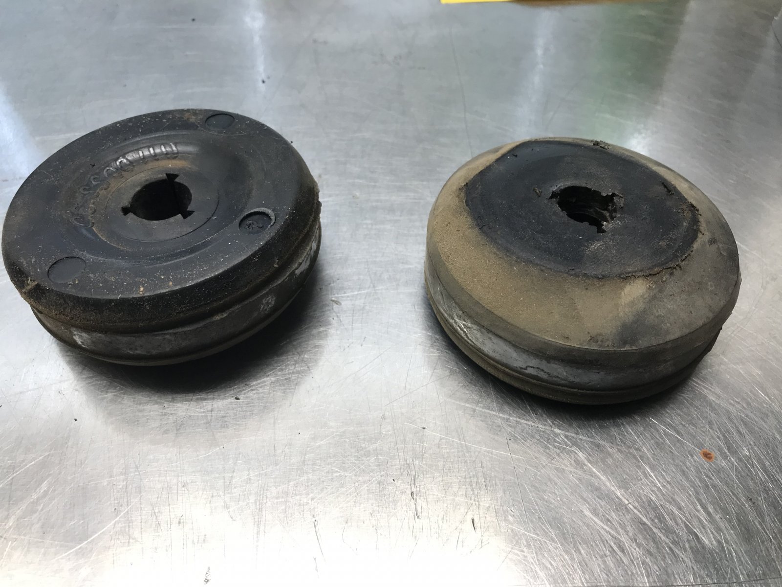

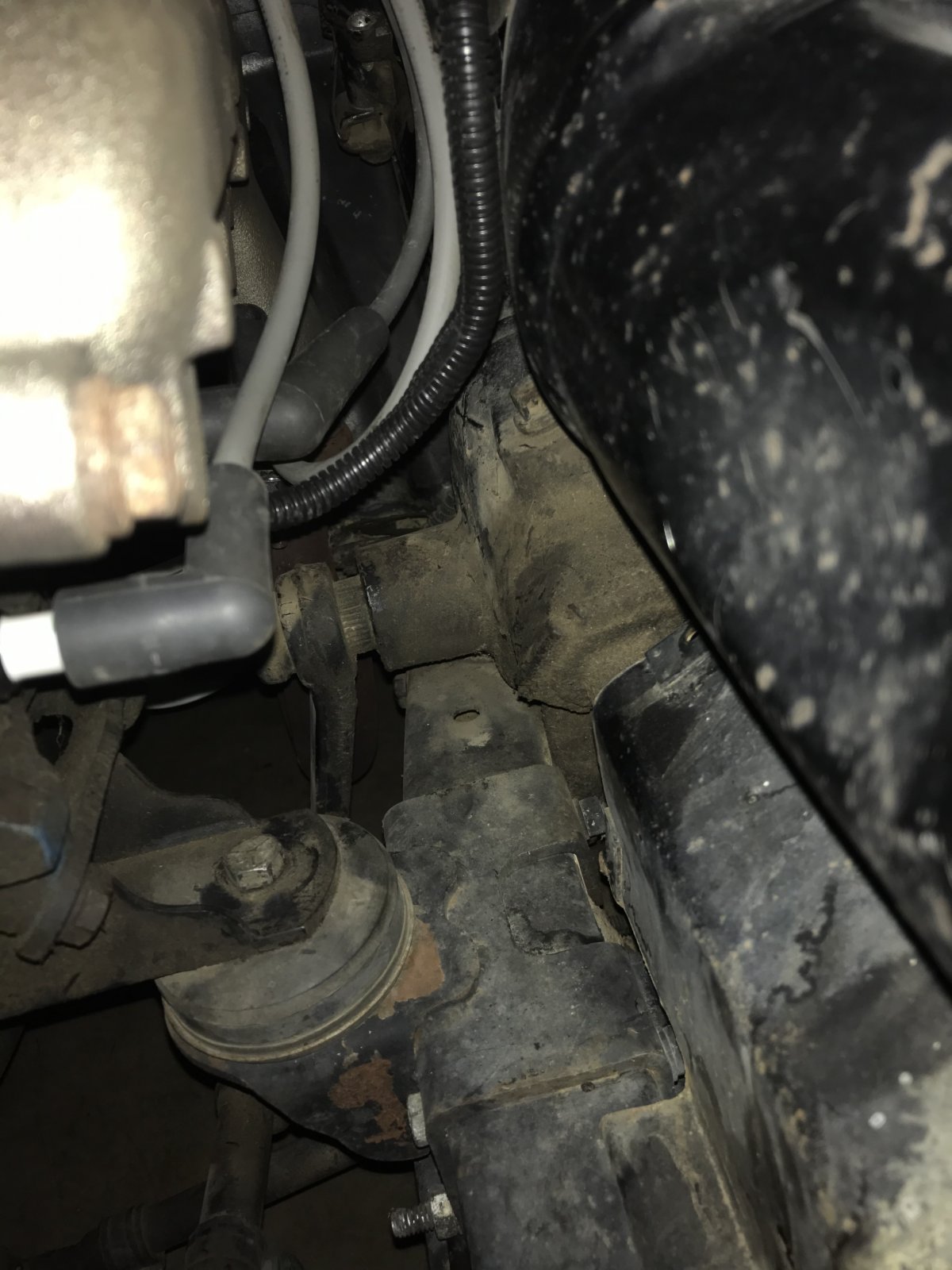

    I won’t be able to continue with my experiments until later this week and will continue to update as I go. I appreciate everyone chiming in. Just for clarity, these are the front engine mounts

    ^^^^^ How close too the steering box is the left engine mount as compared to where the original inline 6 was?
    Why were these used in later models?
    Truck64 and Deuces like this.

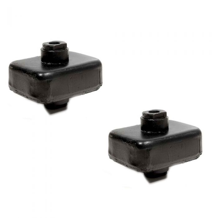

    Original 6 was mounted to front crossmember with mounts like these below. I do wish these cars had a separate column from the box.

    Dueces… this car is one where the column is mounted directly to the steering box so no rag joint. I think the fact everything is solid means any vibration transferred to the frame is amplified through the car…hence my obsession with the front mounts. I found some softer and smaller biscuits (see below) that I am going to temporarily try once I get the car back up on stands later this week.

  19. You are on the right track with the softer mounts.

    Noticed your motor mounts.Those mounts should have another large rubber washer on the bottom side and a shouldered bolt from the bottom to the top with a nut.
    Seeing a bolt going down has me wondering what is on the underside.
  22. 51pontiac
    Joined: Jun 12, 2009
    Posts: 394
    51pontiac
    from Alberta
    Hoop…they have the large rubber mount, flat washer and locknut below. I made sure they are seated properly and right now they are snug…but I have experimented with everything from very tight to finger tight. Thanks for checking!

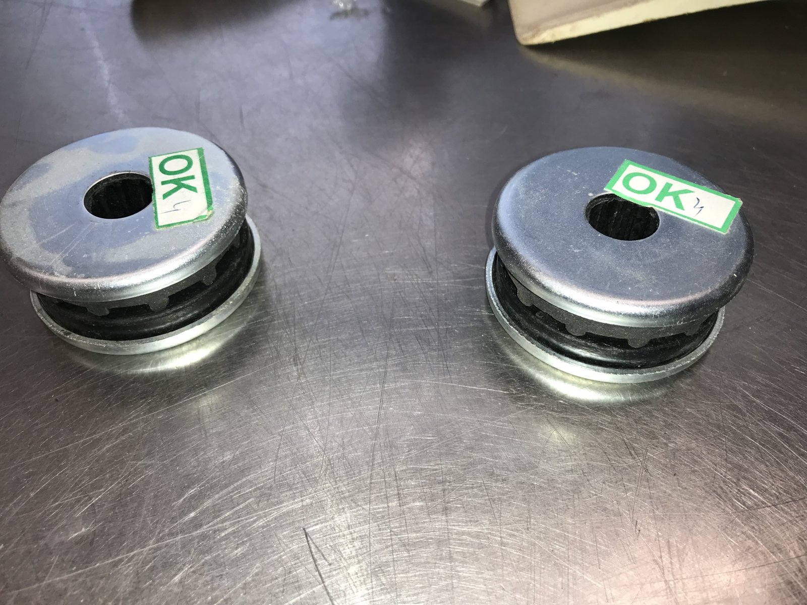

    As the title suggests, I have…with help from the HAMB…solved the vibration issue. As I mentioned in my last post, I swapped out the old Chassis Engineering biscuits for some temporary softer biscuits…fired it up and vibration is basically gone. Obviously these temporary mounts are not suitable for anything but a test but I now know exactly what the problem was. The old biscuits are so hard they E181E857-4AAB-4369-824A-D1A70B7C22F6.jpeg could be used as hockey pucks.
    Does anyone have any recent good experiences with some of the biscuits currently on the market?
