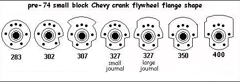

  19. 51pontiac
    Joined: Jun 12, 2009
    Posts: 394
    51pontiac
    from Alberta
    It is definitely a 350 crank based on this chart.
    I am pulling it down off the stands tomorrow and will drive it around a bit. Chances are it is an internal issue but I won’t be able check that out until fall at the earliest.
    Thank you all for the help! Cheers!
  20. "Based on this chart" I am inclined to agree with you BUT, I am not seeing an example of a 305 crank in your chart. As stated earlier, I couldn't tell a 305 crank from a 350 crank when they were both laying on the floor right in front of me. They were visually identical, right down to the same casting numbers.
    Here is a quote taken off the internet, and based on my own personal experience, I can verify that the quote is indeed correct. "They are identical and completely interchangeable. The only internal difference is the bore of the cylinders. The cranks of the 305 and 350 have the same casting numbers and are interchangeable. But the 305 crank is drilled to be lighter."
    I would not be in any rush to rule out the possibility that the crank is from a 305 especially since you did state the engine came from a large volume rebuilder. I am not stating it IS the cause of your vibration, I am saying you might not want to rule it out until you can truly verify that your crank is from a 350 and I know that a visual inspection is not enough to determine one from the other.
    I wish you the best in your search for the source of your vibration.
    Here is a quote taken from https://www.chevytalk.org/fusionbb/showtopic.php?tid/62288/
    "The cranks of the 305 and 350 have the same casting numbers and are interchangeable. But the 305 crank is drilled to be lighter. It will work in a 350 but will cause the engine to vibrate. I had a parts store sell me a 305 crank as a 350. After getting the engine build and installed did I discover the difference. (and much waste time trying to figure out what was the problem). A machine shop help me find the problem and I got the right crank and my problems went away!!

  28. That 305/350 crank explanation surely makes sense. Gee, so the builder must not have "balanced" the rotating assembly? Seems that would be an essential part of building/rebuilding any engine.
    rockable, 51pontiac and Deuces like this.

  30. Deuces
    Joined: Nov 3, 2009
    Posts: 23,882
    Deuces
    Maybe I missed it, but are the flywheel flanges the same between the 305 and 350????....
