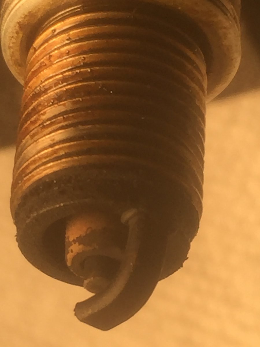

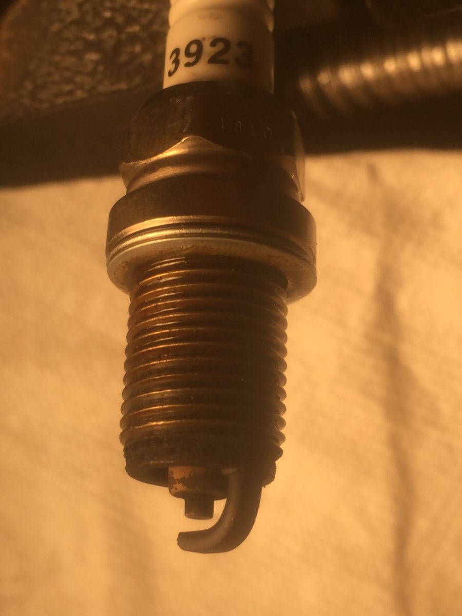

  1. D9BA16E7-224F-4294-9BA4-A60EF66EC088.jpeg 0DBE4EC2-66A7-41E5-9561-B4A5C4731C02.jpeg 750 HP DP, light stumble 2500-3500 in first (4 speed). Above 3500 in first, no problem. 383, 4:11, 69 primaries.
    I have gone to tube squirters, worked w/pump cams and helped a lot. Closed down LSAB 4 numbers, helped.
    So, I’m thinking this ^^^^ richened up idle circuit a little and helped so changed primary jets 69-73. Seems to be the fix.
    I have avoided richening jets due to plug condition. Did peppy cam cause carbon on plug and not necessarily a sign of rich jetting ?
    Pic w/69 jets.

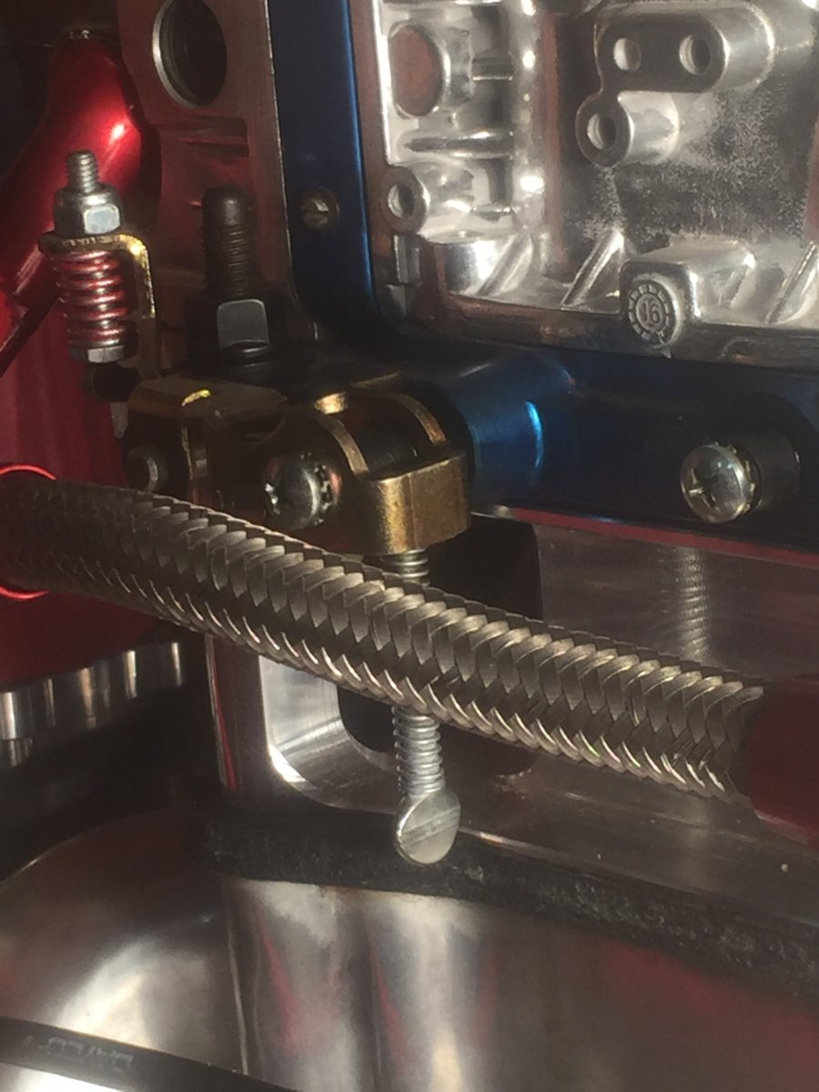

  6. 48D9B730-44BC-42F9-AF42-015A24F043A1.jpeg Idles smooth MOL @ 950-1000 where builder recommended, 4 Idle mixture screws are out 3/4 turn. I can kill engine by turning any idle screw in. Can also idle down w/idle screw until engine just dies out.
    I put thumb screw w/spring on secondary idle. It’s adjusted closed then just a half turn or so to keep blades from sticking. My primary transfer slot is “less than square”.

    I guess my ? is “Are there circumstances when plugs simply
    won’t have that optimum tan
    coating ?”
    Absolutely

    1. What is the compression ratio of this engine?
    2. Is that Autolite 3923 spark plug in your picture out of this engine?
    3. Why is it the engine only sees 10 minutes of run time?
  15. AHotRod,
    Supposed to be 10-10,5
    Yep, plug out of #1 cylinder

    The tan residue on the plug was mostly lead oxide back when I was a pup. Plugs just don't look the same with this modern stuff they call gas. Ten minutes run time isn't enough to burn the crap off the plug anyway. Takes a lot of heat to do that.

  18. “Be sure the spring you put on secondary idle speed screw is not letting the secondary's open some when primaries are off idle.”
    Forgot to mention,
    secondaries open almost even w/primaries.
    The spring is there to keep tension on thumbscrew so it doesn’t back out.

    And that plug looks like it's shivering. Cold. Especially for a ten mile run. Lippy JMO
