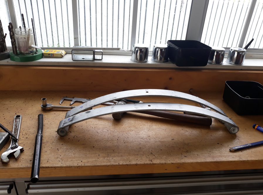

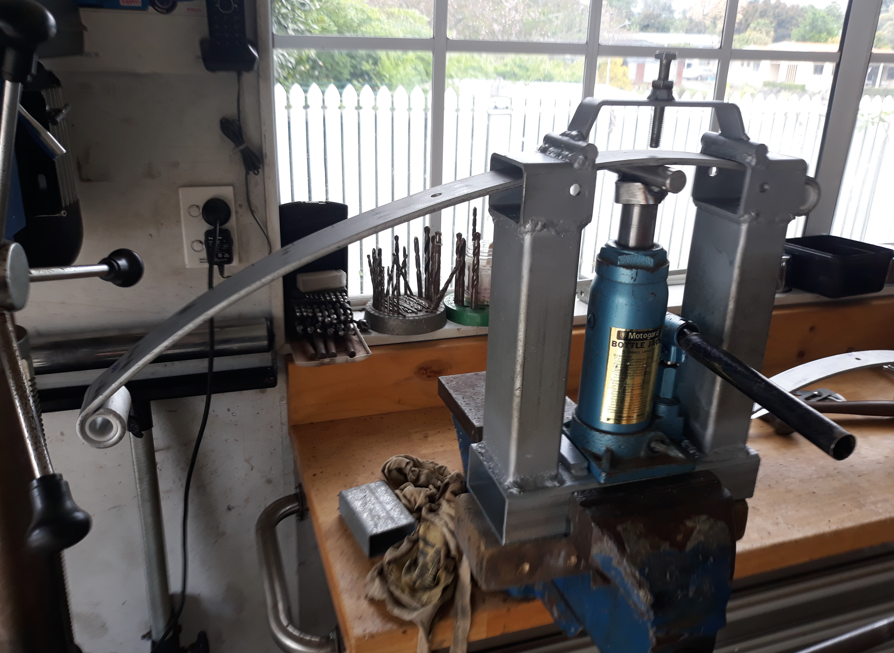

    "Specialist company" means charging too much $$$$ for something simple to do yourself.
    Re-arching springs is not a "black art"
    Spring steel never loses it's rating throughout it's life unless some self proclaimed expert tries to heat them.
    Normally a spring will slowly lose it's "set" through 1000's of oscillations.
    All the spring needs, is to be re-arched in a press [cold] or cold forged with a BFH if you have deaf neighbors.
    Here is DIY spring arching tool I made out of scrap steel [I've posted this here before]
    The most difficult part of the whole job is removing the springs from the vehicle [which you will need do anyway when replacing them]
    Then you need to measure [or chalk on the floor] the arch .
    This method gets the exact height you desire, whereas buying a replacement leaves you at the mercy of the seller's range [they never ask questions about spring load]
    one caveat though @putz many hotrod builders make the mistake of building a vehicle with it too high with new springs, so they simply remove a few leaves to correct this.
    This will speed up the process of the springs sagging due to the stiffness being reduced and the springs will yield.

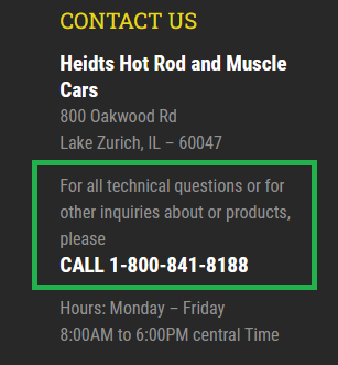

  25. Sorry if this reply of mine seems like too much, but your point is just not true. Chassis Engineering still exists as a brand name and manufactured parts look to be available under that brand name with a new owner of the brand, Heidts. The former owner is deceased, but even if CE were still under his ownership, the owner of a business organization doesn't typically answer the phones and other communications such as technical and warranty assistance and questions.
    The links in @Mr48chev's #15 comment are CE brand products, and the contact information is for Heidts:
    If @putz bought the leaf springs for anywhere near the $1010 advertised price, and they failed to properly suspend the car after the car set (on its wheels or not) with zero miles put on the leaf springs, then that suggests to me that the leaf springs were not manufactured properly.
    I wouldn't pay over $1000 for a set of leaf springs. But if I did, and if they failed like these seem to have failed, I'd contact the business organization that owns the brand name and see what they have to say. They may or may not do anything to help, but we'll never know if they're never contacted.
