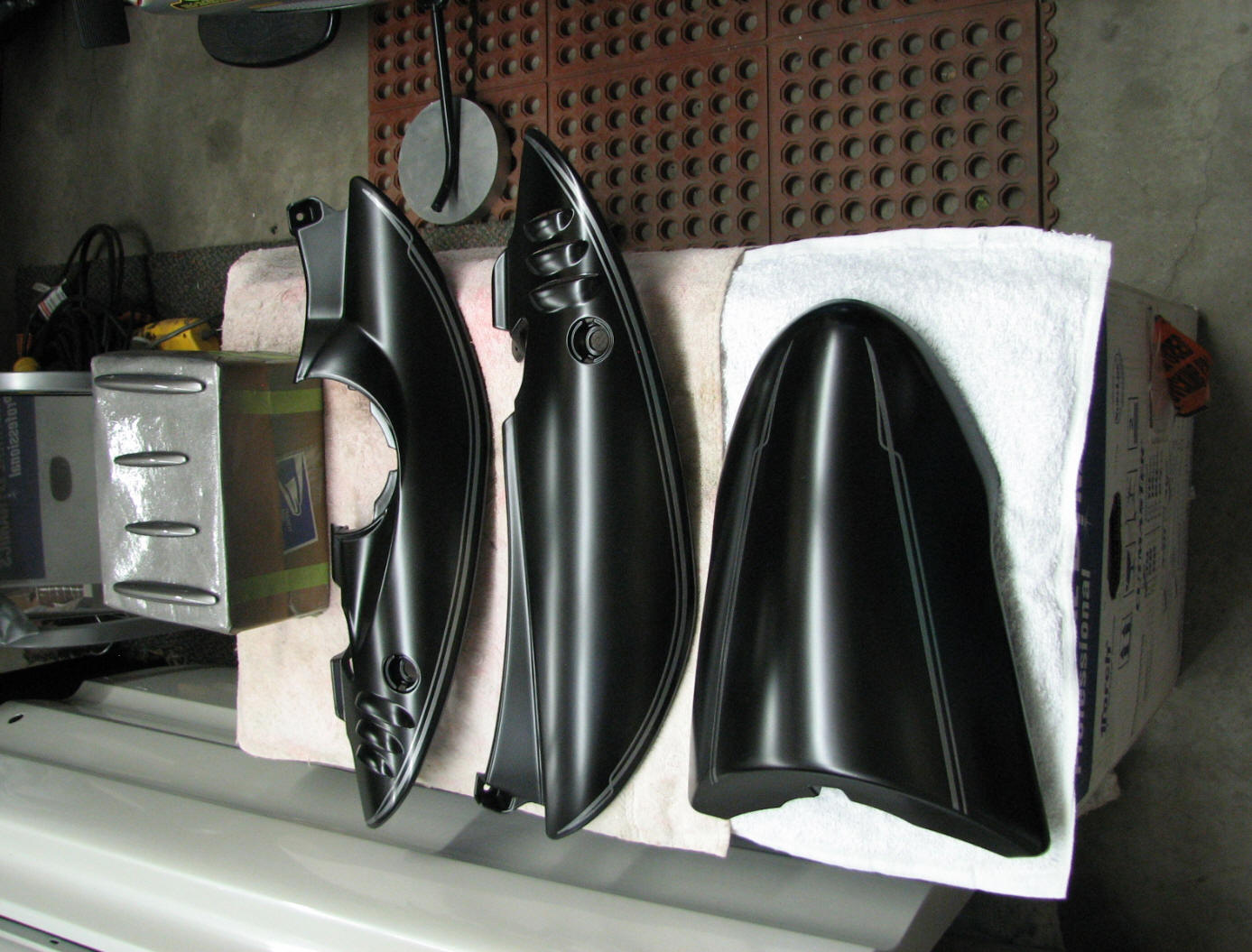

    I agree with sik kreations. I sprayed my rpu with SEM hot rod black, & love it. It comes in quart kits, and gives I believe 1.5 sprayable quarts per kit. It is a single stage, which to me is easier to spray than a base & flattened clear.
    It is VERY forgiving to spray. It lays down really nice, & dries very uniform. Also seems tough once cured, & cleans up perfect with spray detailer
    I think they also may offer a different reducer for different temps. Since I am in Florida, cold temp is never an issue:D
    It really is tough to photograph, it honestly looks a lot different in person - better I think. But here's a few pics of mine(no bikini models included:(), good luck on your project

  23. sik_kreations
    Joined: Jul 14, 2008
    Posts: 436
    sik_kreations
    nice job!
