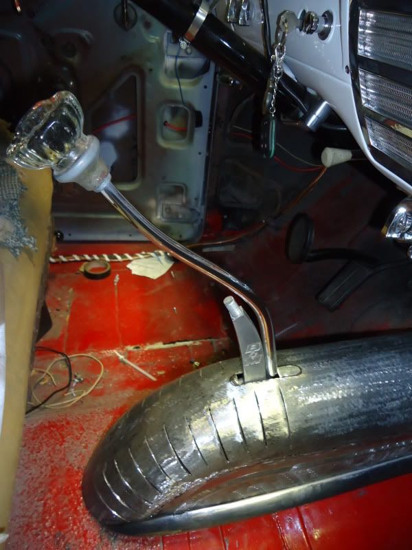

    Its starting to grow on me a little now.
    I got some Stainless cut up and it fit pretty dam nice considering I have know idea what it came off of. I guess thats just one benifit of not being able to throw stuff out.
    I also found an aluminum cover for an electrical conduit fitting that should work perfect for the shifter trim (seen setting on top)
    All trimmed and then welded up some mounting hardware
    so far so good.
    I also started on the new shifter. 1/2" alum bar stock turned down and taperd for 1/2 the length. Now I just have to figure out how to bend it?
    The 1/2" aluminum is WAY stiffer that I had thought!
    Should I heat it before bending?
    " " anneal it w/ the sooty acytalene flame trick?
    " " cut a wooden form from 2x4s and put it in the press (press it to shape cold)?

    I finished up the new shift lever tonight and it freakin came out great!
    machined the taper on the 1/2" alum, did a quick polish (easier to do before bending), and decided on a shape.
    Used a jig saw to cut the profile and drilled 4 holes to "pin" the 2 halfs together and keep them in alingment. I did the sooty flame thing to anneal the alum and loaded it in the fixture while still hot.
    I was really waiting for stress cracks to start showing up , but it formed nice and never left a flaw.
    Lokar eat your heart out ;-)
    jeff

    Love the old door knob, I have ove in my 31 sedan. Looks good
  7. raidmagic
    Joined: Dec 10, 2007
    Posts: 1,438
    raidmagic
    Love it, great work.
  8. Bugguts
    Joined: Aug 13, 2011
    Posts: 685
    Bugguts
    Great idea for bending the shift lever. I'm gonna give it a try now that you proved it can be done.

    I really havnt figured out how to mount it yet so ill be thinking of that.
    And yeah, all those cuts were there for the shaping of the 5" pipe. The whole thing will be welded solid, smoothed and painted to match the dash.
    jeff

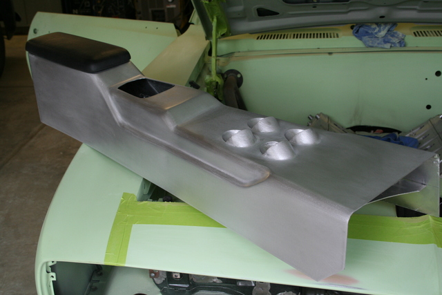

    Here's one I made.

    Joined: Mar 6, 2010
    Posts: 6,059
    1971BB427
    from Oregon
    $129 at Harbor Freight. I bought one on sale years ago for $99, and use the heck out of it. I never thought I'd use it for as many things as I have when I got it.
