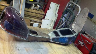

    my '51 plym has one of those ugly B&M shifters in it that just wont fly w/ me.
    Id been trying to figure out what to do w/ it and then I remembered the left over pcs from the grill suround I made.
    The suround was made from 5" exhaust tubing that was sliced up, bent, then quartered.
    And this is the left over pc that id been moving from one side of the garage to the other.
    After a little more trimming, It started to match the idea I had:
    The plan is to weld in some sides and paint it white to match the dash. Probably cut off the B&M lever and make a new plain one too, but still not sure how I want to trim the slotted opening, maybe something like whisker strips?
    question is, will this look stupid?

    The whole concept is wrong on an early custom...but.. the shape and size kinda looks ok to me. But get some old chrome rod to replace the modern flat chrome handle. And, if you could find some curved diecast or stainless trim pieces to make that hump look more like it looks old ?

    I like the idea about adding some sort of stainless trim.
    As for the lokar shifter,
    there is no fun in that, plus theres so many other parts I NEED to buy to get this car done.
    jeff

    I think it could work...maybe a clock, or something mounted in front of the shifter? You could even use an late 40's Plymouth hood emblem, or trunk emblem mounted in...with some round bar cut in half and bent to the same lines as the piece you already made to look like belt line trim!

    I would mount the mechanism on top of the gearbox , make a nice swan neck from round stock and a generic leather boot to cover whatever sticks through the floor ...
    A center console has no place in a cool custom IMHO .

    I agree with the others, change out flat bar to a round bar, and then a small boot. Consoles of any kind, just seem wrong on those era cars.

    -Ive heard that before, but Id have to think that builders must have came up w/ ways to change the tunnel area.
    - A colum shifter would make me happy but I doubt its doable w/ the driveline swap.
    - I do like that center hood trim w/ the lighted pc. That could be used as the courtesy light instead of the dome light.
    Heading out to garage soon to see what I can screw up!

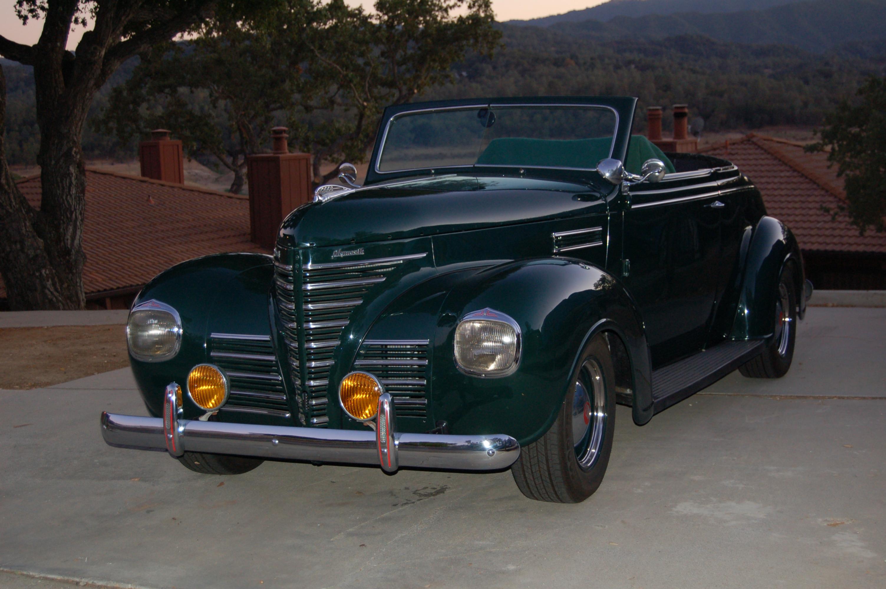

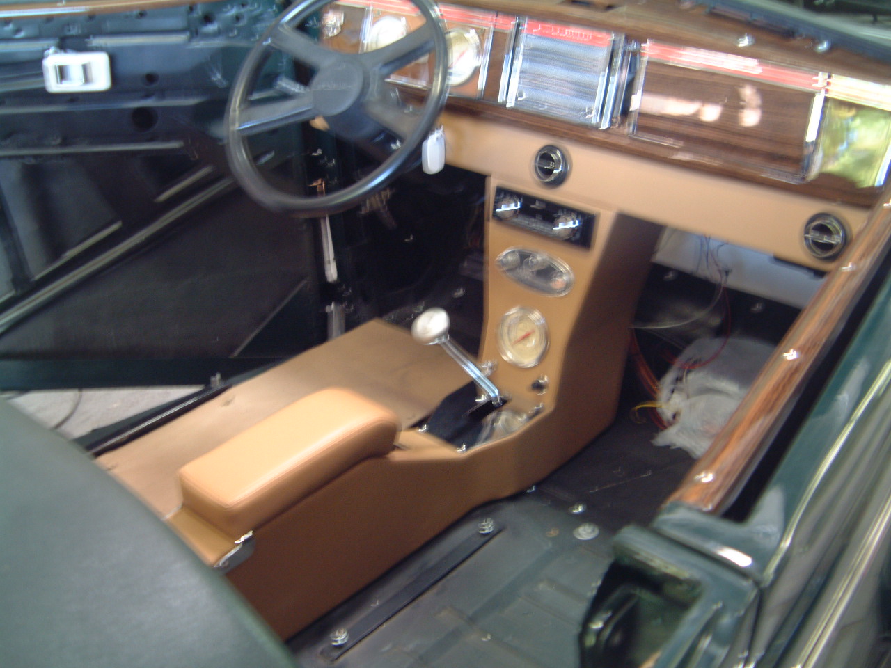

    My '39 Plym. conv cpe is what some people would call "a Resto-Mod".. I wanted to keep the car as stock looking as possible, improving everything mechanical for safety and good drivablity..
    When I was planning the rebuild, I noted that there was limited room for a late model tilt column with a column mounted shift lever.. I had looked at a couple of '39 Plym coupes with this modification.. The shift lever hit the dash in park..
    Wanting to keep the dash as stock looking as possible, keeping the NOS '39 Philco radio that I had been lucky enough to find, add AC ducts, a tach, CD player, etc., plus the buckets seats from a 325 BMW, required the creation of a consul..
    As you can see from the attached pix's it all worked out very well. The steering wheel shown in the pix has been replaced with a Carrea Classic Banjo..
    I'm using the same idea on my '49 Olds 88, stock looking dash w/GM tilt column, column shift, custom built consul.. Bucket seats from a 325 BM'r..
    I'll retain the stock '79 Olds steering wheel for now.. I might try cutting down the '49 Olds steering wheel to about 14" later on.. It can be done, I've seen one that was done... Very pricey!!

    For some reason the pix of the consul in my Plym did not make it through cyber space..
    I'll try again...
  19. jcs64
    Joined: Apr 25, 2005
    Posts: 528
    jcs64
    ^^^^ super helpfull^^^^^^
    just a little progress today
    jeff

    Looks good, maybe take sum 3/8 tubing and weld it around the perimeter of the bottom, give it a little more character. Just my 2¢

    Already on the to do list.
    Maybe even polished stainless tubing.
    jeff

    I'd work more at having it blend in than stand out. I think you are on the right track for that though. Make it look like it was always there from the day the car was built and not an add on and you are good to go.
