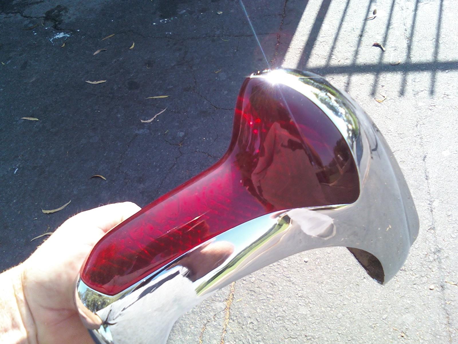

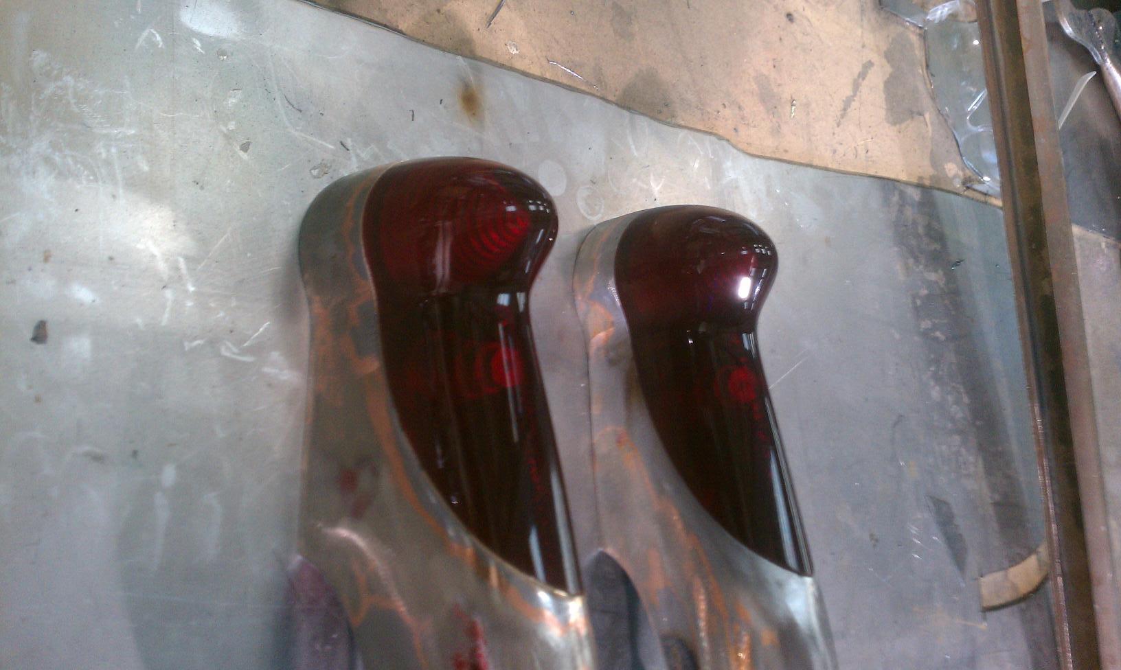

    Make a silicone mold around the shape you like then tint up some resin. I do it when i make these types of lenses..

    from CenCal
    Those bumperette lights look great!
    I did some molding with silicone molds back in the late 60's. Worked great and nice surface finish.
    Still had lots of bubbles though.
    Gee, now I wanna try the centrifuge thing. :)
  21. Matt, I have admired your lenses for some time now - beautiful work by-the-way! Can you tell us how you deal with potential bubbles?
    Thanks,
    Dave
  22. slddnmatt
    Joined: Mar 30, 2006
    Posts: 3,685
    slddnmatt
    when i make them i try and form the molds so the air bubbles all float to the top or backside, it can be tricky... I also will pour the resin through a strainer and pour in a thin stream like was mentioned before on page 1.
