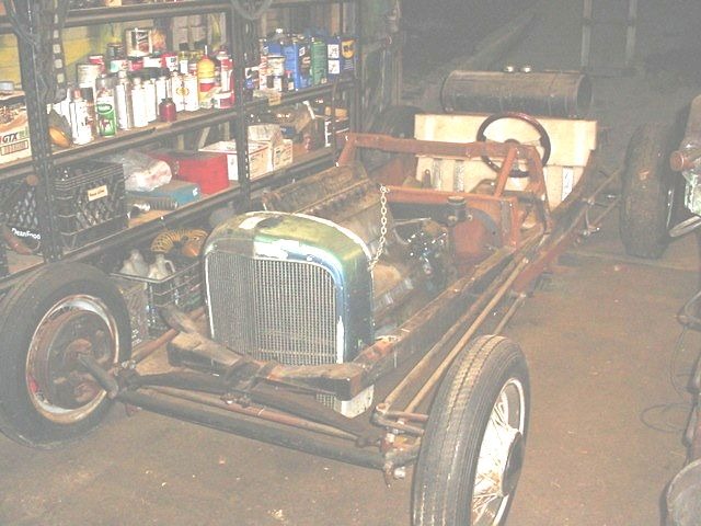

    Several years ago I started a lakes bucket style street build and came near to finishing it before I had to trade it. Part of the deal was that I'd help finish it. Unfortunately life got in the way and it gathered dust for awhile.
    Well, it's baaaaack. The project changed hands recently and the new owner of the stalled project brought it back to me to finish. So here'tis .......
    Cassandra's previous build photos are here. I'll add new ones as I get the work done.

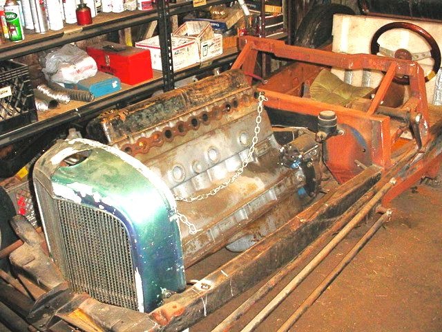

    Well, Kiddies,
    Life got in the way for a few years again, but I kept'er around, and finally got to get back to work on'er this year. :)
    In the interim I came across a different mill, and decided to continue the project with that instead of the slant six. I still like the slant of the slant six, but'll now be doing it with an L8 instead. :cool:
    A bit of back story on this car. It started as a parts pile my buddy gathered back in '71, did some assembly on, but sold to me a few years later when a move made it necessary. I took it quite a bit farther along, but swapped it for the parts for my HAMBster just before it would've hit the bricks. The friend I swapped it to later died, and his son eventually brought it back to me to finish whenever I could get back to it. So it's been over 45 years in the build so far.
    Who says "I'll get to it some day." doesn't actually happen? Especially when the thing keeps showing up on my doorstep repeatedly? :D
    I've adapted the new mill ('40 Buick 248) to a first gen, push button 904, positioned the package, and'll be working out the engine mounts next.
    Four SUs for suck, and a cobbled header set for blow. Just a nice comfortable street machine for this old fart.
    Here're a couple pics of'er today.

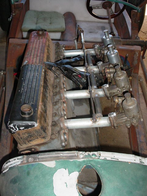

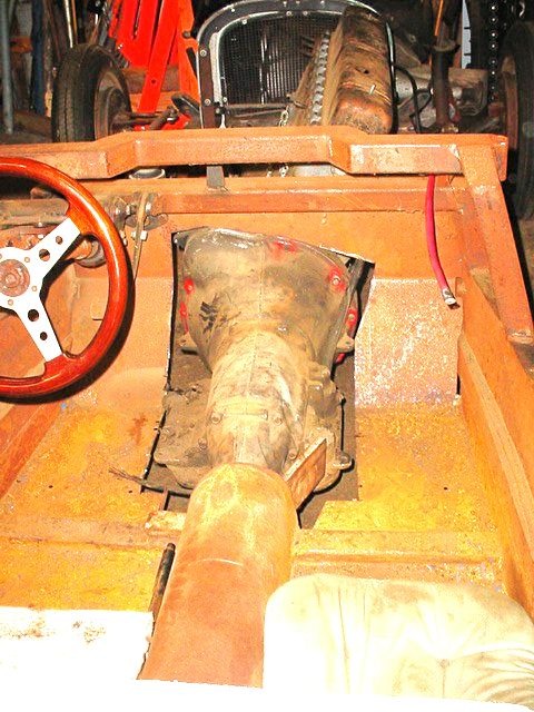

    As stated, not a hurried (re)project. ;)
    Finished up the tunnel. Not much space left for gas pedal & feet after surrounding that 904, eh? Have to go with a spoon pedal & heel rest after all.
    Included two hatches, for rear trans mount & front U-joint, and for access to fittings & adjustments on 904.
    Also did (very) preliminary mock-up of carbs. They'll wind up about 5" lower, but about the same distance from head. :cool:
    Seat cushion boxes next, then finishing up the firewall. Manifold & headers after that. :D

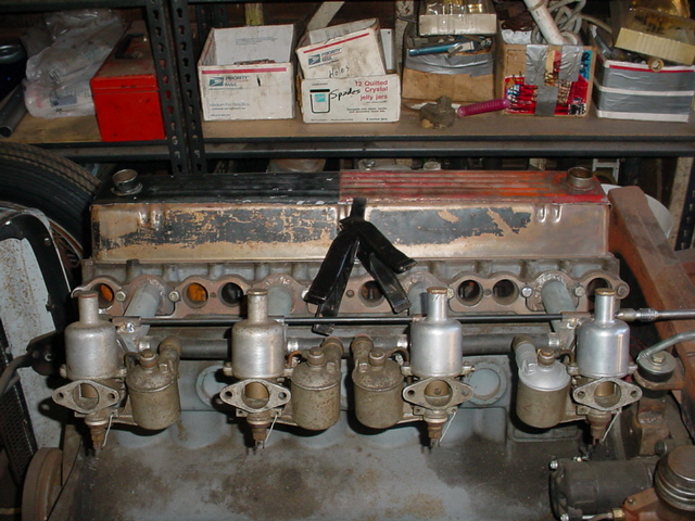

    Well, got a couple more days to fiddle about in the garage. So ........ cobbled up the spoon gas pedal, and did the initial carbs mount. Used a head flange set I found on the Buick site, some EMT I had laying about, and a bit of plate for the carb flanges. All in all a nice couple days. Hope to get in a couple more in the next few weeks as well.

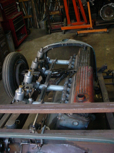

    Managed a bit of playtime today, so added the balance tubes to the intake.
    Also started swapping parts from the 6 garbage SUs (I got in a parts swap awhile back) to paste together 4 that'll work. Number stamped the intake runners & carb bases so's I can keep'em in order in the future as well (beats juggling'em :rolleyes:).

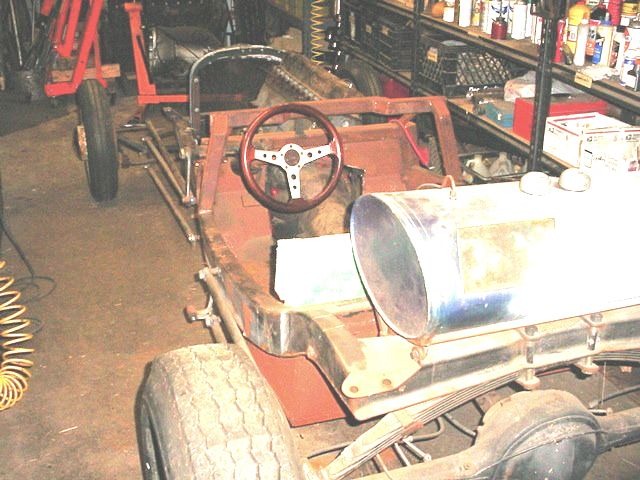

    Got in a few more play days, so did a bit more on the throttle linkage. Also got the rear brakes & parking brake functional (fronts need new drums yet), fuel system complete from tank through pump, and roll bar added.
    Then rolled'er up to the HAMBster's trailer so I could bring the HAMBster down to go through the bottom end. Musical Cars is pretty much the name of the game when you hobby out of a 1918 one car garage.
    DSC00002.JPG DSC00010.JPG DSC00005.JPG DSC00006.JPG DSC00009.JPG DSC00011.JPG DSC00012.JPG

    Well, the Rose Parade's over, and the usual month's worth of follow up ran into nearly two this year. But in March I finally got back in the garage, and managed a bit of fiddling around on Cassi. I went through the four SUs, and ordered the bits & pieces I'll need to get'em up & operable (mostly gasket & seal sets).
    I also cobbled up, mounted & connected the "common" shaft for the throttle, so the linkage is complete that far now. The return spring at the firewall's a temporary clurge only. Unfortunately, Burlen wants more than I can justify for their repro levers & adjustable links to the carbs, so that'll have to be the next cobble there.
    Then, per an idea I had a few years back, I butchered a pair of slant six rocker boxes to mock up a cosmetic "cap" for the Buick rocker box. If it comes out decent I may go ahead and use it eventually, I rather like the way it could look.
