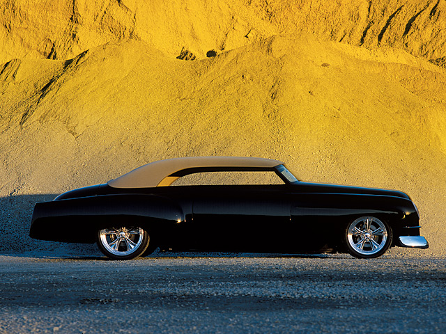

    I did this drawing for another hamber some time ago.

    Really like the look of this one. Was it a true convertible? As I can see the vent window is a convertible vent window. That's one of the problems I'm going to run into. If I chop the windshield I will have to chop the vent window/frame. Not that easy...
    Again. The top was already cut on this car. I did not do it. I would not have done it. So, trying to make something out of nothing. Thanks for the comments as that is what I was looking for.

    For a Carson top this car to me has nice lines and would be a design to go from. Just one of my favorites even though it is a different make.
