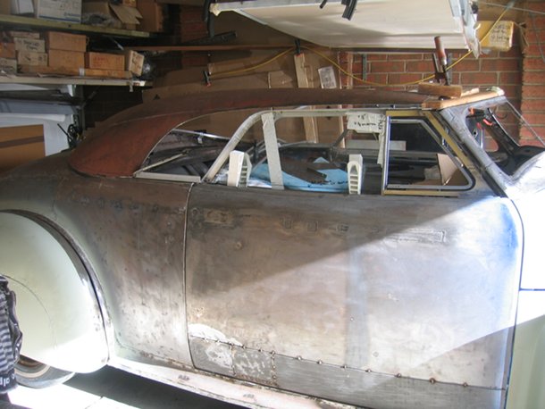

    Couple weeks ago, at Antioch Billetproof, This car was there. It has seat belt buckles welded to the inside body and to the carson top bottom rail. Top under construction. Pic #1

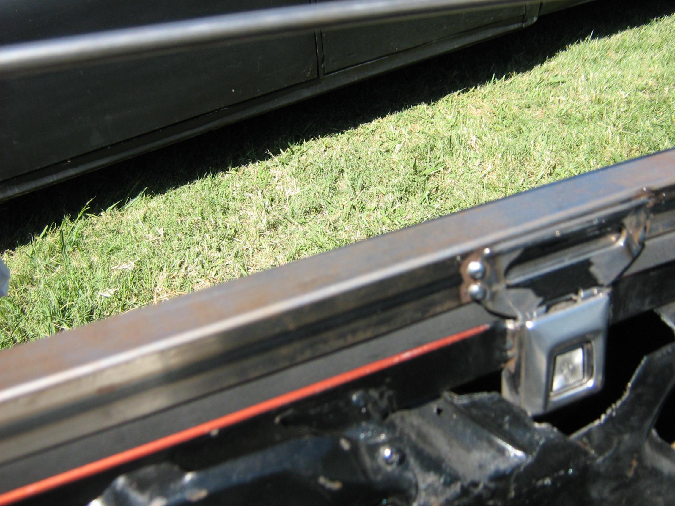

    Also at Billetproof was this method of fastening a top to the front. Simple design, uses to "L" brackets drawn together with a bolt and wing nut. Pic #2.

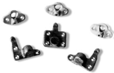

  15. Was going to take a closer look at these latches I saw at the '50s. One's a cam style and the other a loop and hook.
    Different of view of the latches at Bruce's web sight:
    http://www.horkeyswoodandparts.com/page17.php
    They don't have a built in adjustment; but was thinking they could be set up initially with a 3/8" or so shim plate under the hook, that could be replaced with a thinner shim plate to tighten as needed.

    Nice looking latches . The compact one on the left looks compact & the security pin is a nice touch to prevent an accidental pop. I got the Bob Drake reproduction latches & visors when they were on sale for 20% & 25% off. The cost is sickening & still uncomfortable with the costs a couple years later. The Bob Drakes are well made SS & polished out like the ones that you are looking at. The latches shown appear to be quality being all stainless and full polished similar to the Drake latches. The stainlees will be stronger than a chromed cast brass. Either of these latches could do a car proud if they work out. The 40 - 48 Ford tops used three latches.& have a set of locating pins built in. It may be a question if there will need to be locating studs on top or windshield frame to locate and resist lateral movement so there is less strain on the latches.
    This may help with a decision. https://www.bobdrake.com/FordItem.aspx?Item=11A-760-K
    Good luck with your quest to find latches.
