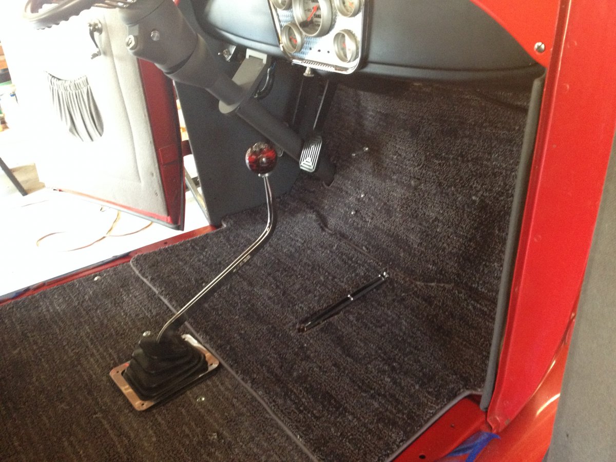

    Here's the new carpet in my coupe, purchased at home depot and has a glue-on binding found at Bond Products. I made a paper/poster board pattern and used this to cut the carpet. The razor knife is definitely the way to go as it is Very sharp (ask me how I know). My A is flat so I could use the household carpet and that was because of the color that I wanted. Searching the net I found Bond Products which has a variety of glue on binding and that's what I went with (no sewing). IMG_0484.JPG IMG_0485.JPG IMG_0486.JPG IMG_0488.JPG . My only regret is that the carpet is a longer nap which is not the best to use with the Bond binding, but I really am happy with it. Good Luck with yours, Carp.

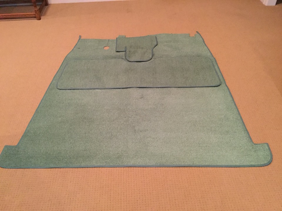

    I purchased bulk automotive carpet by the yard from Stockinteriors.com. After cutting and fitting I brought it to a local carpet shop to have the binding sewed on. To fit the contour the firewall hump I used a garment steamer to heat and shape the carpet.
    42168868_1823490897688383_6565333776564486144_n.jpg 34135475_585716325148140_3736660090556514304_n.jpg

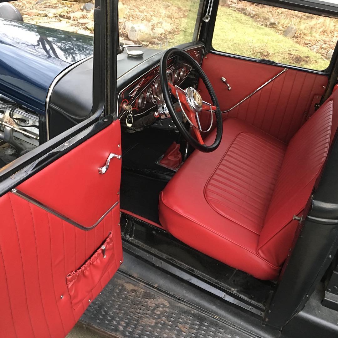

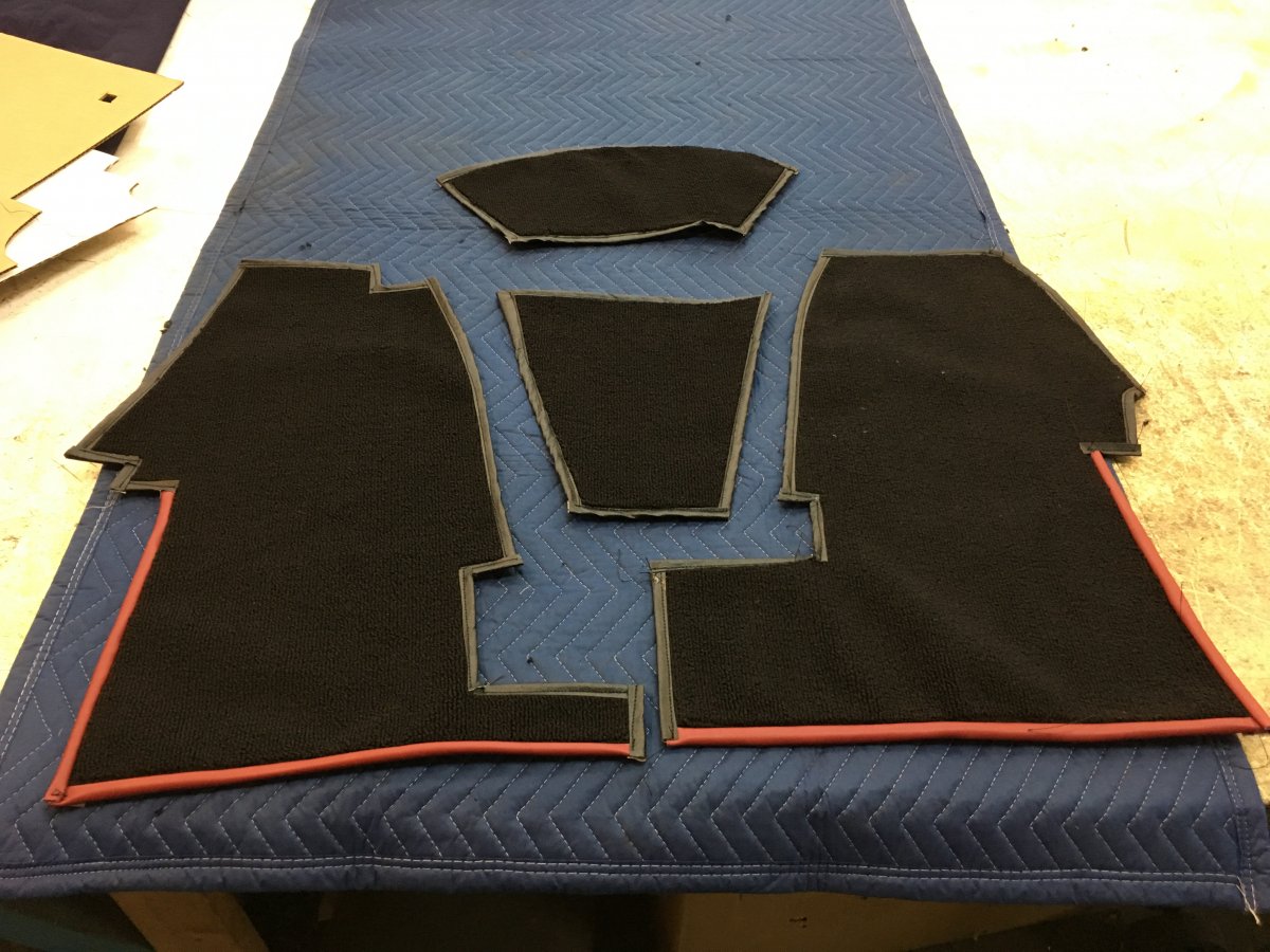

    I did what '49 coupe did.
    I had the OEM rubber floor mats in all my '34's.
    A local guy replaced his rubber mats with carpeting from LeBaron Bonney. It totally changed the inside of the car. I decided to put carpeting in one of mine.
    I made craft paper patterns and traced onto the german square weave carpeting.
    I took the trimmed pads to a local upholsterer for matching tan welting. They came out great.
    Little by little I did all the other '34's. It quiets the inside down a lot.

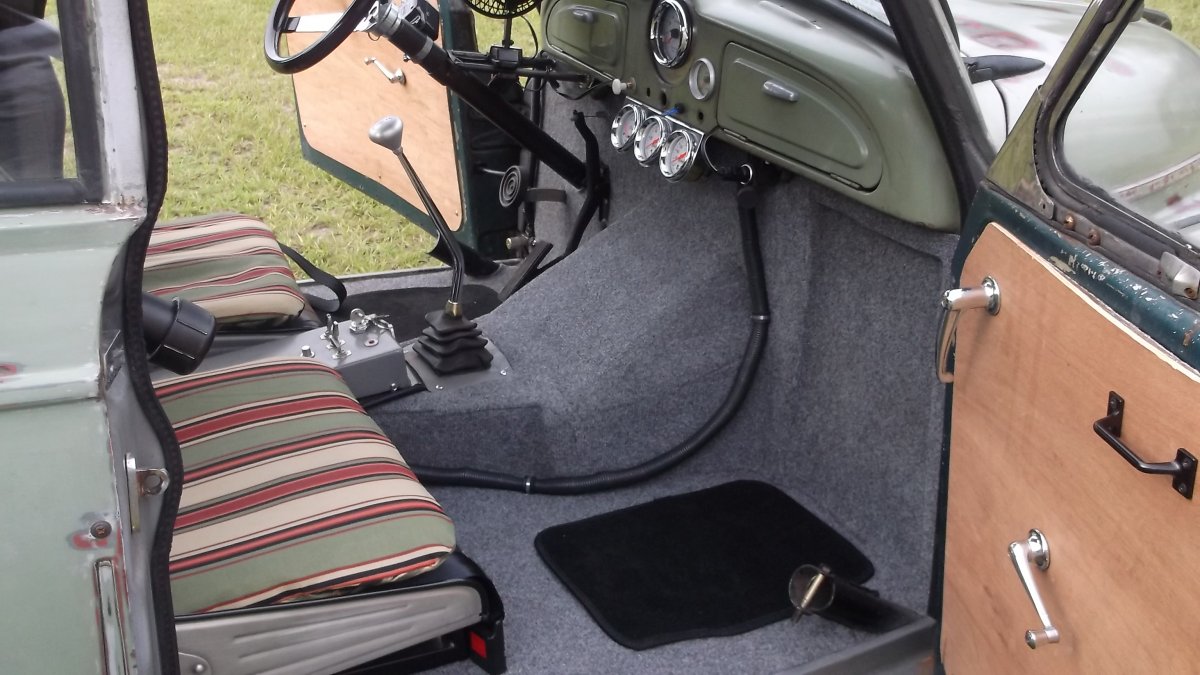

    home depot indoor outdoor carpet installed by my wife. in my old pro street Morris Minor DSCF0950.JPG
    dana barlow and catdad49 like this.

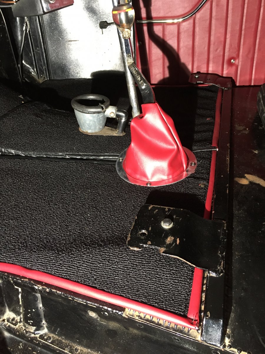

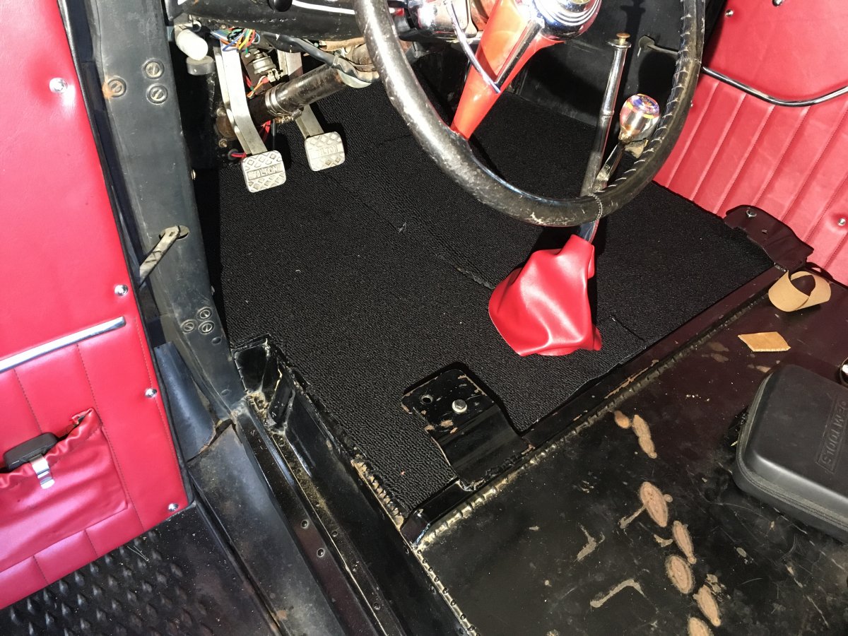

  28. I am also looking for carpet for a Model A coupe. my floor is pretty much stock, save the location of the shifter and E-brake. I have been trying to find a stock Model A carpet without the holes precut but not having any luck. I guess I will have to just get some bulk carpet and do it myself.
    Chappy
    catdad49 likes this.

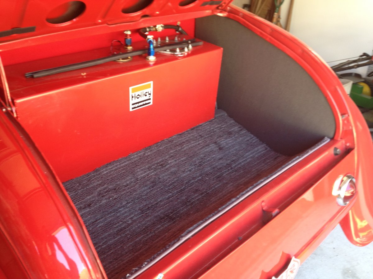

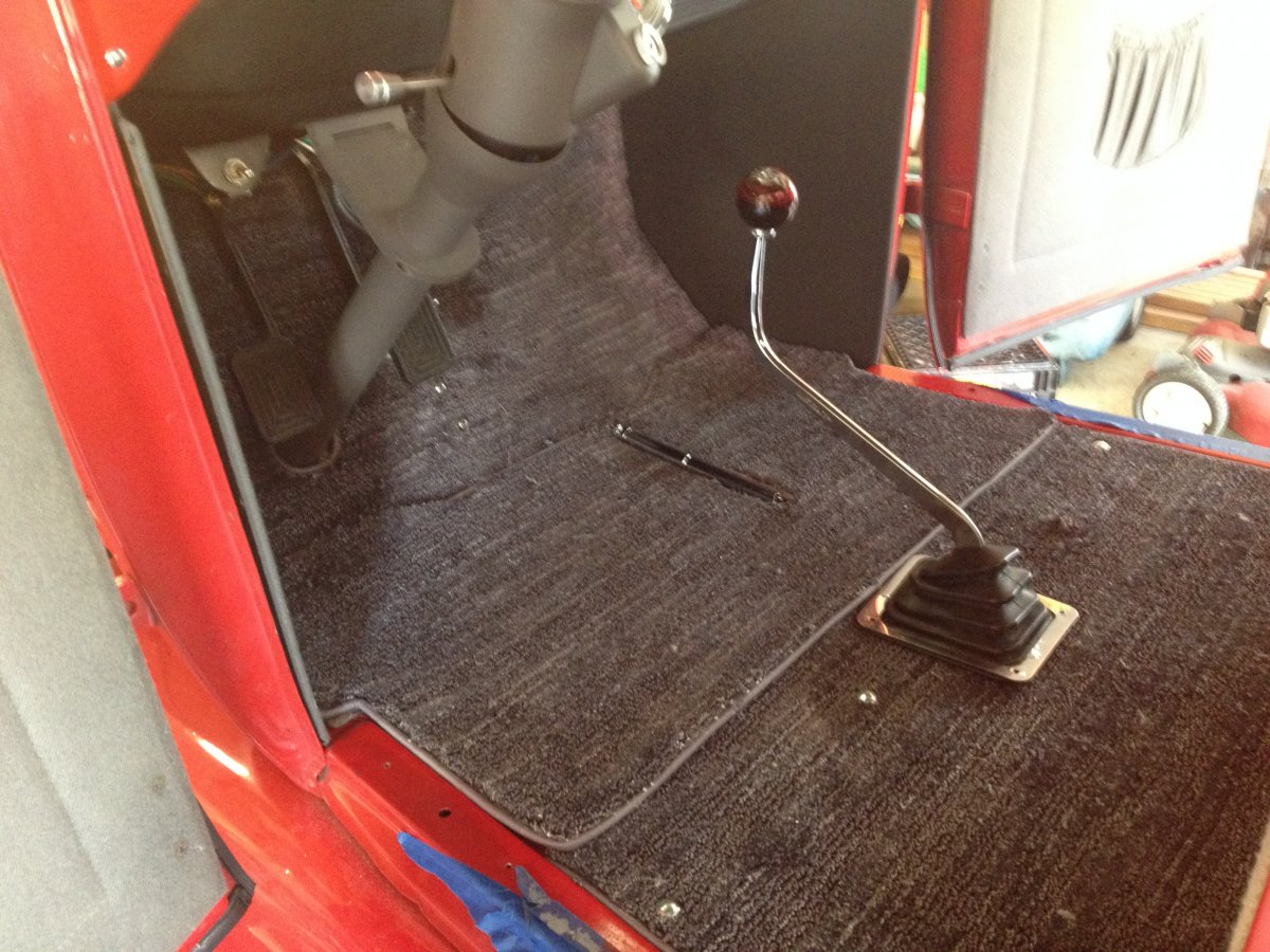

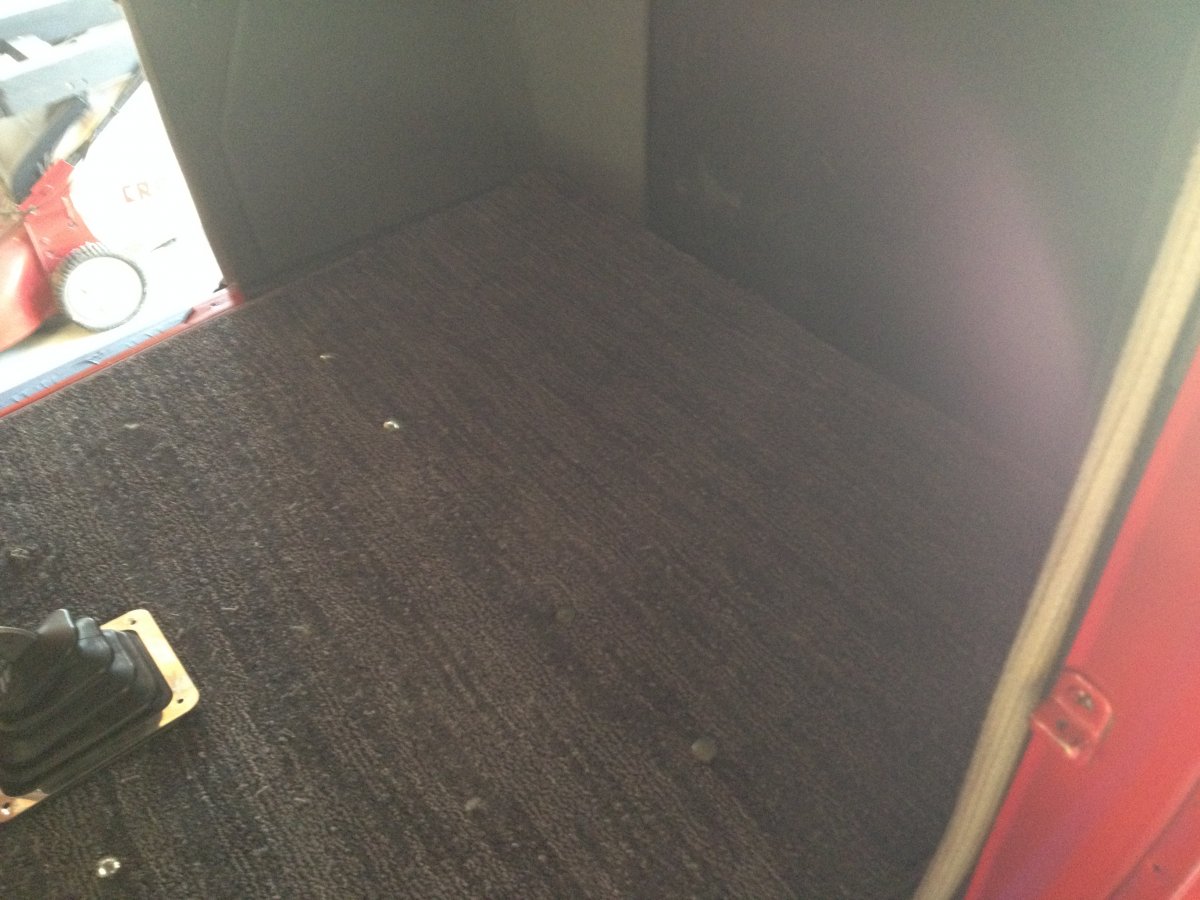

  29. Automotive Carpet in my Model A and my first try at carpet binding. It turned out OK for a first try. I used snaps in the corners so it is removable for cleaning and to dry it out.
    Originally I had outdoor carpet, but it was pretty crappy and didn't stay in place.
    reagen and catdad49 like this.
