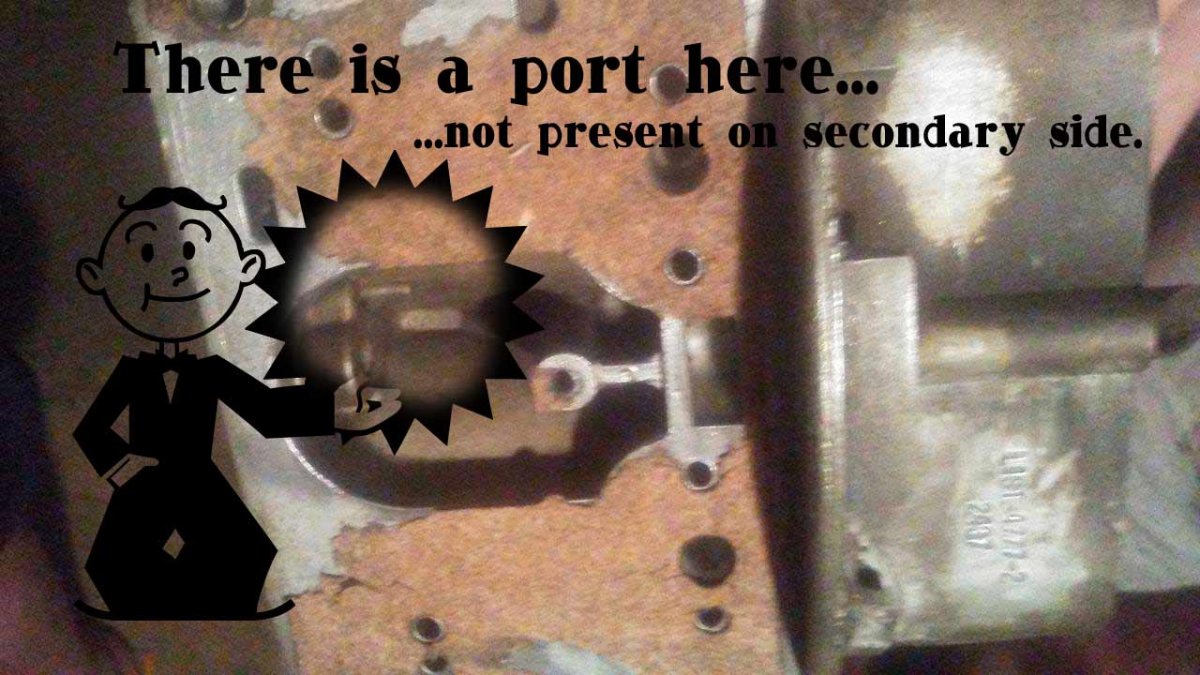

  5. Nope. Just the one on the primary metering block...there wasn't one on the secondary side.
    Yes, there are still incriminating bits of gasket matter left on it, my projects have to wait until I get other people's finished...making a set of headers for a friend's non-hamb '80 elky, he's too cheap to buy the ones made for the job, so I get to refresh my memory on welding thin metal with oxy/acetylene before I dive into the necessary bits for my own "git'r done" rig.
    *edit* the second photo's text should say "passage," not port. It's late for me and I have to be up in four hours...good evening HAMB.
  6. Then that's why it ran like crap on the secondary now primary side. How many power valves here ? [​IMG]

    Some double pumpers come with 1 power valve, some with 2. The 4777s just came with one.

    I've got a couple of 4779 750 double pumpers on a tunnel ram that don't have power valves either.

  12. I dunno...just looks to me like somebody removed the primary throttle shaft and when they put it back, they put it in from the wrong side, leaving the throttle linkage on the passenger side of the carb.
    hillbilly likes this.
  13. Exactly what they did will remain a mystery I suppose, but I'm pretty sure I can get it to work. Thanks for all the feedback y'all!
