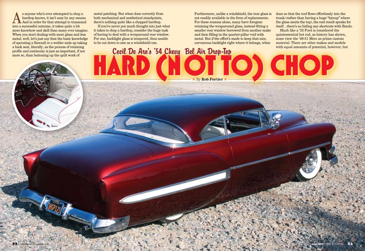

  23. cain
    Joined: Nov 28, 2006
    Posts: 153
    cain
    from riverside
  24. That's beautiful Cain.
    Want to share the details?

  26. cain
    Posts: 153
    cain
    from riverside
    i used black ppg. then white pearl. the ureathane kandy house of kolor
