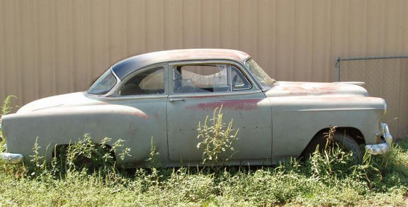

    I just realized my 1953 Chevy is a club coupe and that the back window is smaller and a totally different shape. my question is can I cut out the club coupe back glass and put in a belair back window? any help is appreciated.

    Maybe. Some cardboard templates of the roof/window contour of one model, when compared to the other, should give a pretty good idea if the basic contours are the same or close enough to be easily adapted.
    Personally, I like the smaller back glass on the much rarer club coupe.

    just eyeballing the side profile of your coupe in your albums I would think it would not work. really need both cars together to figure it out for sure though.
    I like the coupe back window better anyways.

    Sorry man it's a no go.
    I know the Coupe glass is hard to find but it'd be worth it.

    Don't be so hasty...can you not graft in the rear section of a belair roof and window?

    The 53 150 business coupe is a pretty rare car and very desirable, I'd sell it and buy a 210/ Bel air.
    Besides the back glass the top is a lot shorter and the quarter glass is different.

    Whoah! Don't cut that car up. To some that's a much more desirable version. There is a guy out there willing to trade you a Sedan or Hardtop for the Coupe. OR just sell it outright and find a '53 or '54 of your liking. That Coupe is a great start on a super cool Custom or Hot Rod. If I still lived in Texas we'd be talking about when I was coming to get it.

    It's not that I don't dig the car that much, it's just that the look of the back window on the 53-54's is one of my fave things about the car. That's why I wanted to know if I could graft that section on to it, I really appreciate your photoshop, that's the kind of info I was looking for.
