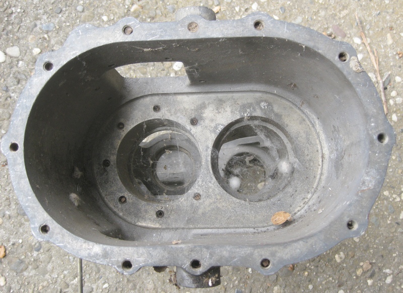

    Another choice: this is a housing for a two-speed Halibrand quick-change. Used in front-engined Champ cars way back when. Larger diameter axle flanges, 12-bolt instead of 10,
