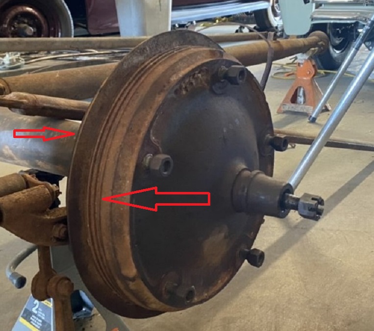

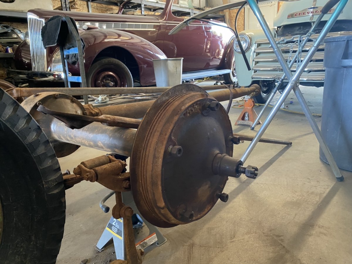

    Picked these front and rear ends up out of a field on the Tejon Ranch in ca. The guy said it was from a early car.
    I don’t know specifically what they would have come off of other then something mid 30’s Ford; as they are mechanical breaks and wide 5’s.
    Any insight as far as to car or truck, and maybe what year?
    Please and thanks... IMG_0302.JPG IMG_0301.JPG IMG_0300.JPG IMG_0299.JPG IMG_0298.JPG

    Curious why not also possible they are 1936? What detail(s) tell the story?
    Ray
    warhorseracing likes this.
  3. Fordors
    Joined: Sep 22, 2016
    Posts: 5,412
    Fordors
    The quick spotting feature is the cable operated brakes but in addition the distance between the perch bolt and the king pin is shorter than ‘32-‘36 axles.
  4. gimpyshotrods
    Joined: May 20, 2009
    Posts: 23,333
    gimpyshotrods
    Also, the "snout" on the front drums is too short. 1936-only had a wider front wheel bearing spacing, more like previous models.
    Atwater Mike and Hnstray like this.
  5. 31Apickup
    Joined: Nov 8, 2005
    Posts: 3,379
    31Apickup
    35-36 had the spring perches as part of the rear radius rods.
    adam401 likes this.
  6. Can the old wide five drums also be dated by the wide flange and three fins ? I have wide five drums in the pile with real deep fins and also shallow fins like the OP has posted.
    BTW LooseCannon, Nice find, looks like the parts were well protected from the elements.
  7. Another feature for identification is the round back front spindles.
    irishsteve likes this.

    1937 or 1938 Ford
  9. rusty valley
    Joined: Oct 25, 2014
    Posts: 3,885
    rusty valley
    i think those drums with the tall fin are aftermarket. i have some too
  10. 42merc
    Joined: Dec 19, 2010
    Posts: 899
    42merc
    One more item.
    Check the torque tube about midway for a grease fitting.
    A '38 has a solid driveshaft, with a support bearing that requires grease.
    The '37 used a tubular shaft and does not use a bearing, therefore no grease fitting.
    alchemy, Dedsoto and Hnstray like this.
  11. Great info right there......was just looking at an old wagon frame past it's prime.....thought it a 37/38 because I didn't know.
  12. Marty Strode
    Joined: Apr 28, 2011
    Posts: 8,911
    Marty Strode
    Also, the '37 has a 10 spline pinion, as compared to the more valuable 6 spline in the '38 to '48.
    42merc likes this.

    And the '36 spindles backs are rectangular, not round .....
